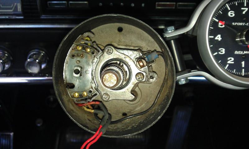

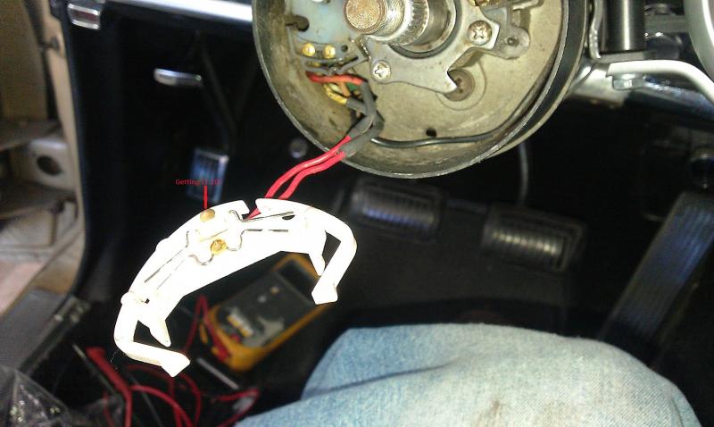

I replaced the cancel cam as one leg was broken off the old one and would only cancel on left side.
Now after replacement the directionals don't work at all.Got one of the cancel cams from rockauto. Did i hook it up wrong? Instructions were very vague.
See photos, are the conductive rods suppose to be bent up?

Looks right but be sure that the pins make good contact! know issue with those it has to be mounted for it to work ground and all.
