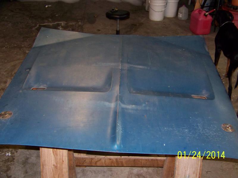

Has anyone taken a 70 charger hood apart ? I 've drilled all the spot welds out but I'm unable to seperate the two pieces

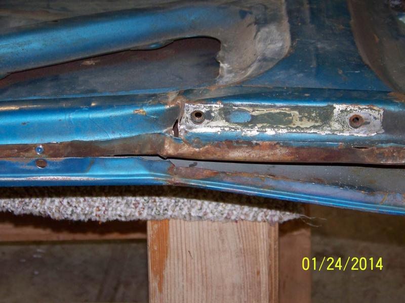

The hardest part was the line of adhesive that was still doing its job at the rear of the hood just in front of the vents on the '71 hood. I literally had to cut through that with Japanese pull saw. You've got to make sure that the adhesive aren't still holding before separating the parts or you'll distort the skin.

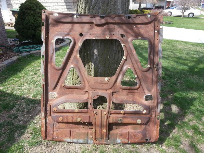

Here's the hood. Somebody forgot the hood pins twice once was me. All the spot welds are drilled out and I have worked a putty knife along the front edge. Any suggestion ?

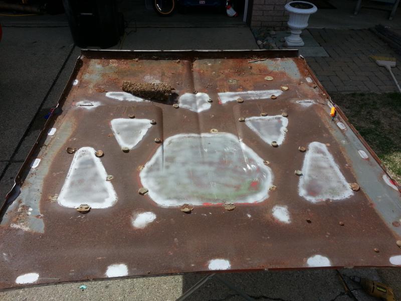

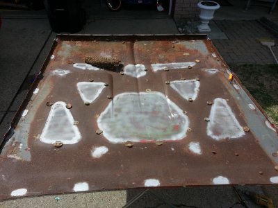

Well it's been done. Was looking for info on doing it and found this thread. Luckily the filler that supports the skin gave up long ago and mine came apart rather well.20140427_154054.jpg20140427_154125.jpg

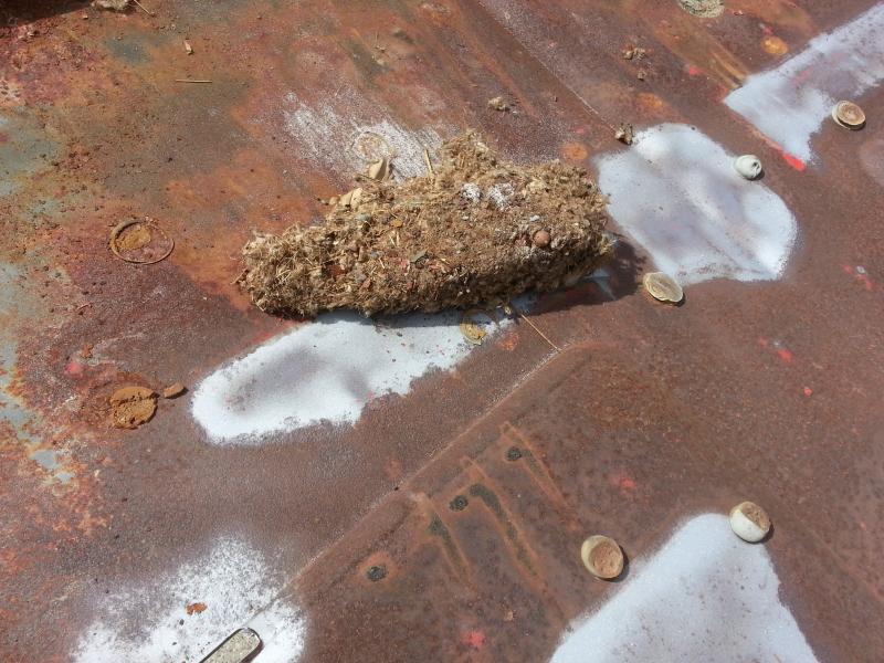

glad I did pull it apart. Some critter made a nice home and accelerated the rust process.20140427_154102.jpg
