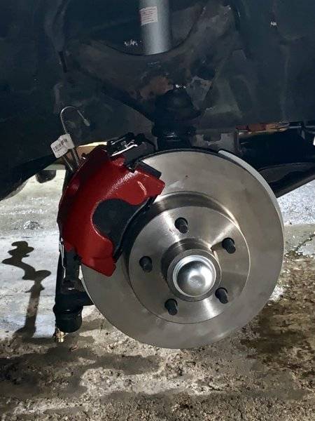

just upgraded to front disc brakes and I noticed that once you engage the brake pedal and let off, the caliper doesn’t really have a way to return, in other words the brake pads drag on the disc a little while rolling. Is that normal?
Drag is okay, lockup or not rolling is bad. Make sure you have clearance for the MC to fully return. If not it may cover the return holes in the MC and you’ll build pressure that results in lockup.
I assume you are talking about clearance at the pedal and rod?
The action of the seal lip when pedal pressure is released, results in pulling the piston away from the brake pad slightly. This relieves the pressure applied to the rotor by the brake pad and allows it to turn free. The travel is so minute, you won't see it, but as the rotor spins freely, you know it did. Problems arise when the piston sticks in the caliper bore, and cannot move back. The constant pressure will destroy the pad and rotor.
A slight drag is normal, you should be able to turn the rotor by hand with little effort.
Real pretty! Need to pull mine, and get a good coat of paint on 'em.
Just for grins. Those calipers are what I call 'sliders'...opposed to the pin type, what mine are. Both are fairly common.
On the sliders, all simple to see, the outer part of the caliper 'moves' very slightly, sliding against machined sections in the inner (fixed) half. Lol, or is it reversed.
Anyway, the two mating machined areas, on both parts are fairly close. In time, can rub down a little, and rust, or collect dirt, either that can make that sliding movement hang up. Nature of the beast!
Don't know if it can still be found, but Lubriplate made a brake lubricant, along the lines of engine assembly lube, but much thicker.
On those slider type calipers, all four machined surfaces needed to be cleaned, and then lubed, a simple thin wipe, to slicken the surfaces, and a little protection from rust.
Movement is only enough to relieve pad pressure, slight drag.
