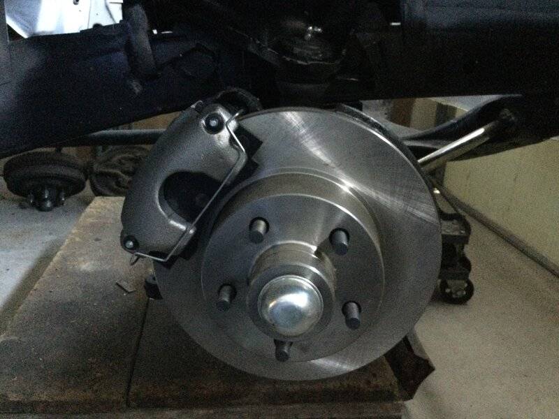

Hi Clazar,
I too really like the old school look. I’ve done two front brake conversations, both where 1972 small bearing spindles. If your so happen to find the small spindles at a very good that’s an opinion. Then the other small detail is to find the caliper brackets for a good price. These pin floating caliper brackets are going at a premium. Most every dealer paddling spindles and brackets for a brake conversion have slider type caliper brackets, I’m not a fan of the slider type. That doesn’t mean they don’t work less better, just my preference.
I just installed the setup on my 68 Charger. These were off of a 72 Charger. The only difference when installing these on a 68 Charger, the spindles have to be reversed and the caliper is installed on the back side of the rotor because of the location of the sway bar mount on the lower control arm.
All of this information might not pertain to your application but I just thought I would toss in my two cents worth, here’s a picture of the Charger
