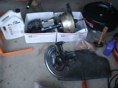

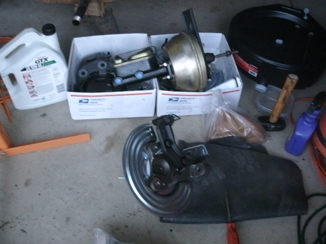

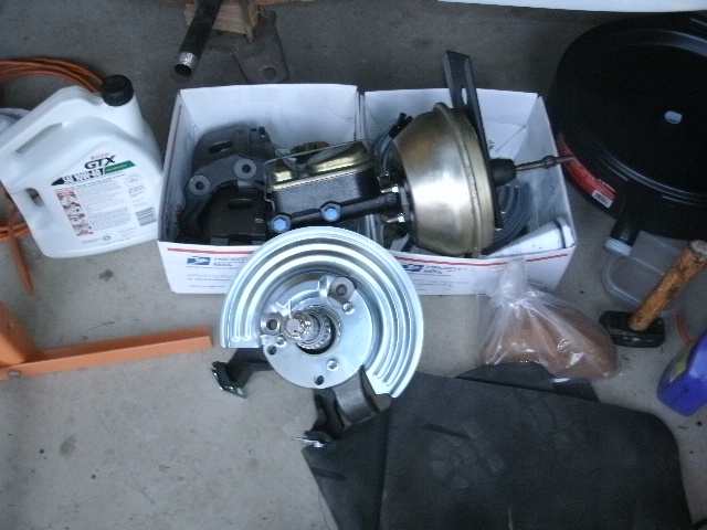

Here are some pics of the stuff I got from Ramman.

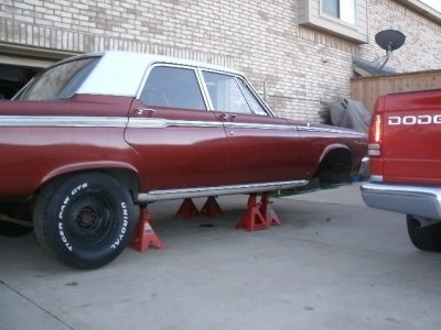

We're still workin' on it. Between the weather and some parts delays (we're rebuilding the entire suspension too with Firm Feel stuff), it's been slow going. Got the front end together except the HD strut rods as they accidentally sent me A-Body rods. We're working on the rear end this weekend. Replacing springs, shocks and brakes back there too, as well as adding a FF sway bar.

Bought the Ramman conversion looks like good quality as in previous pictures from Dwintx also using drilled and slotted rotors from summit racing.Going to be a while before installiation doing an engine conversion also.
