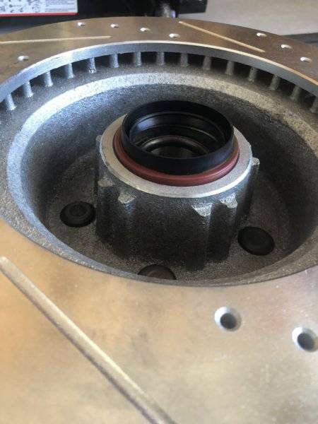

Which way does the seal go on with disk brakes?
It’s a red seal with a soft black rubber seal.

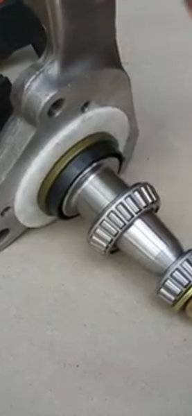

I bought these from Doctor Diff. He says the 2nd pic is correct.

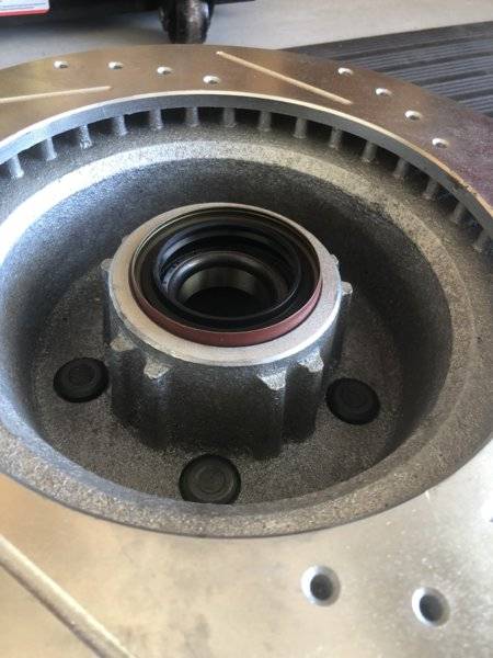

The first pic is a screen shot from The Ram Mans video. It’s already on the spindle and that would mean the last pic is correct.
These are Wilwood brakes.
Ram man? Go directly to jail, do not pass go do not collect $200!
The outer bearing is on backwards also.
Why question Cass? He’s on our side! Picture 2 is correct. L@@K at it in your hand and learn why. Then teach someone else.
