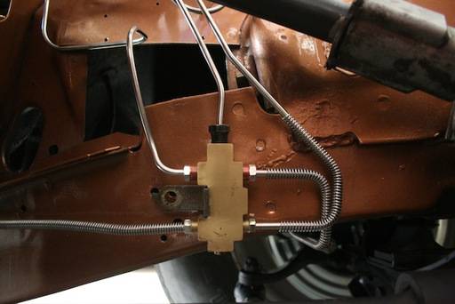

i Converted My 68 charger To a Disc/Disc Setup From Wilwood..
Just Wondering Ig The Stock Distribution Block Will Work And How Do The Ports Direct Flow?
I Plumbed In a Proportion Valve To The Line To The Rear.
-Bottom Left Line To Rear Brakes.
-Top Left Line To Front Passenger Side Brake Caliper.
-Top Right Line To Master Cylinder Rear Brake Resevoir
(Smaller Resevoir)
-Bottom Right Line To Drivers Side Brake Caliper
Top Middle To Front Resevoir
Of Master Cylinder
(Larger Resevoir)
Does This Sound Right??
Thanks

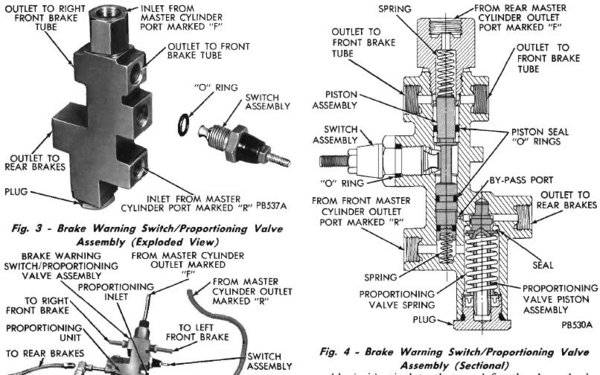

It looks like the valve in the diagram has a built in prop valve as opposed to the plain distribution block with a prop valve plumbed into the rear brake line after the dist block that the OP described.
Something doesn't look right. Top right is inlet from master for rear brakes and outlet to rear brakes is on the bottom on the opposite side? Top right should be to driver's side caliper.
On disc/disc master reservoir be the same size? Don't for sure but... The description of master doesn't sound right, thought larger reservoir was in the rear for front brakes? Any pics of master?
I think distribution block/prop valve are terms that are used interchangably, in this case I believe the ops pic is truely an a automatic prop valve by the presence of the brake warning switch.
I also agree with Fran something looks off...feed should come in the end split across the front with a single rear outlet..
Is a there a manual prop valve installed at the rear? I guess I misunderstood. It should not be needed with the automatic.
