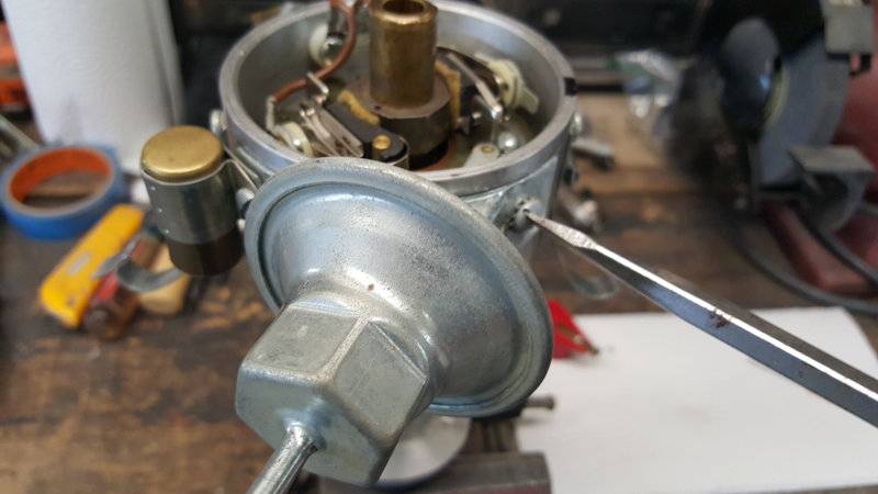

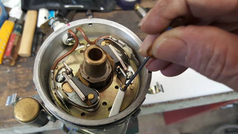

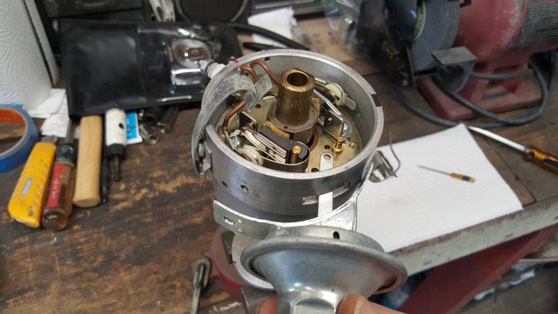

You should be able to do it in the car as long as you can get to the screws that hold it onto the distributor. Here is a removal of one on a Mallory distributor and should be similar to what you have. All are pretty much the same for the exception of the fastener inside that holds the arm on. Some don't have a fastener at all.
If it is a Prestolite,you'll have a hard time doing it in the car.The little clip that attaches the arm to the pin on the breaker plate is not the easiest thing to remove and as small as it is you can lose it quicker than you can imagine.
