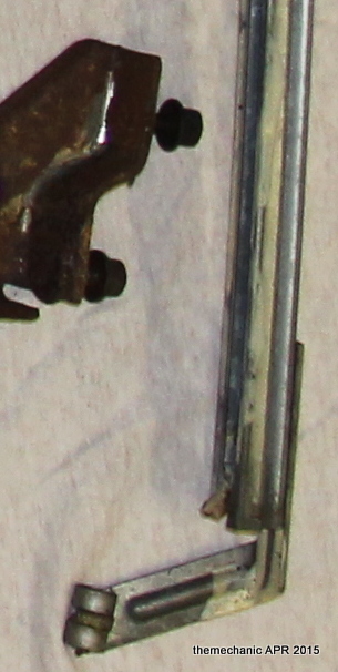

I need the part that secures the vent wing frame to the bottom of the door so I can adjust my window. Anyone know what it is called and where I can buy one?
Here's a photo:
Thanks FBBO.

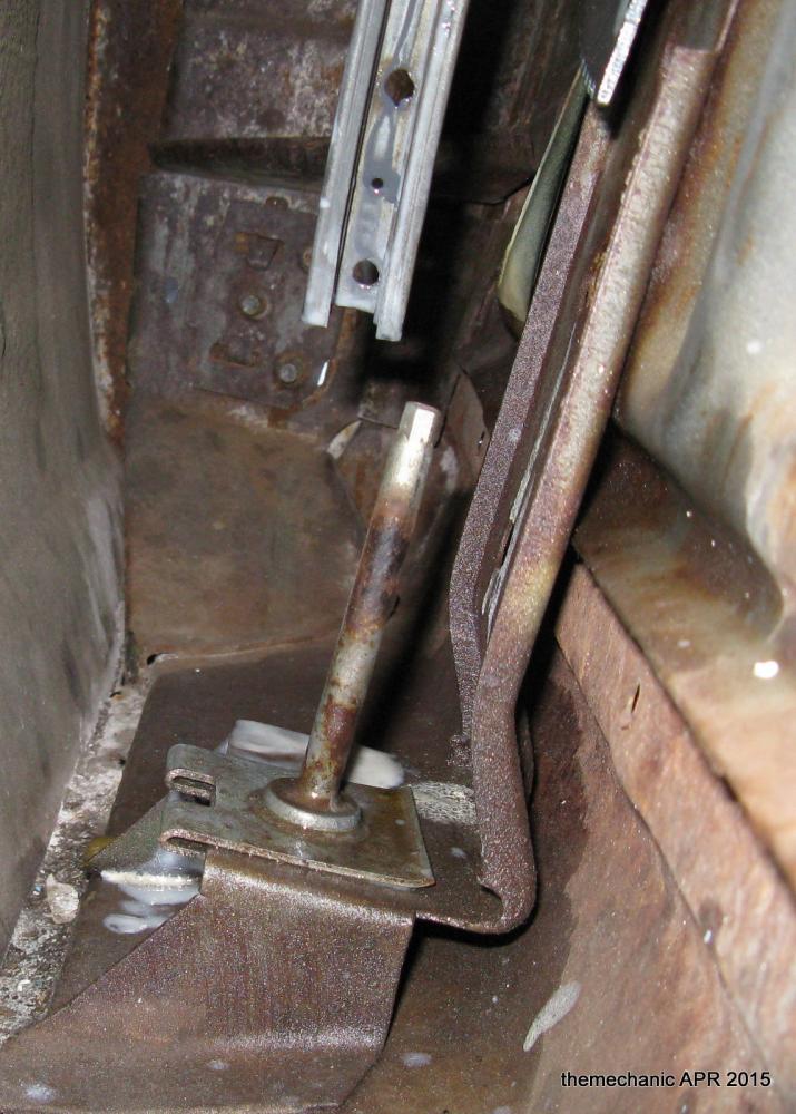

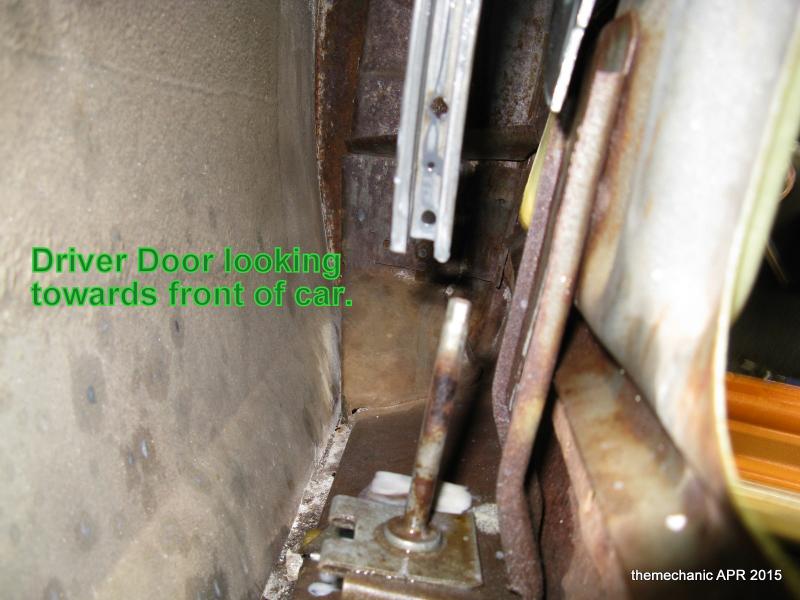

There is an angle bracket that is riveted to the channel and has a loop that goes over the post. Look in your other door to see if it has one then you'll know what it looks like.
Maybe it is spot welded to the channel.
Sorry, you'd think there'd be more pictures for that price.

Mine broke the weld so I used 3 stainless screws and nuts and bolted it together... Has not been an issue since..
