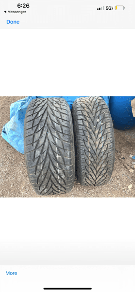

Do you guys think these wheels and tires will fit?
mopar951
5:09 AM
Sep 28, 2024
74
12
California
Hi guys I’m looking at some wheels and tires for my 69 coronet 500 I was wondering if these would fit? He said the back spacing is 4 1/2 my car also has a 8 3/4 rear axle
You need to know the back spacing or off set.
the diameter will make them interfere with stuff. The widths and backspace are fine but the sidewall is too tall.
