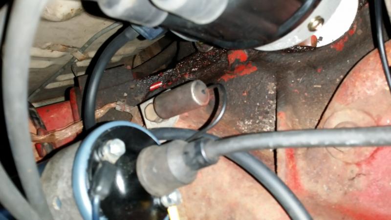

WP_20151103_002[1].jpgI will take a photo, it is not the ceramic one mounted on firewall. I did replace that which I think is the ballast resistor .... it is right next to the voltage regulator, on passenger side. The one I am wondering about is mounted to the block under the ignition coil next toward transmission.

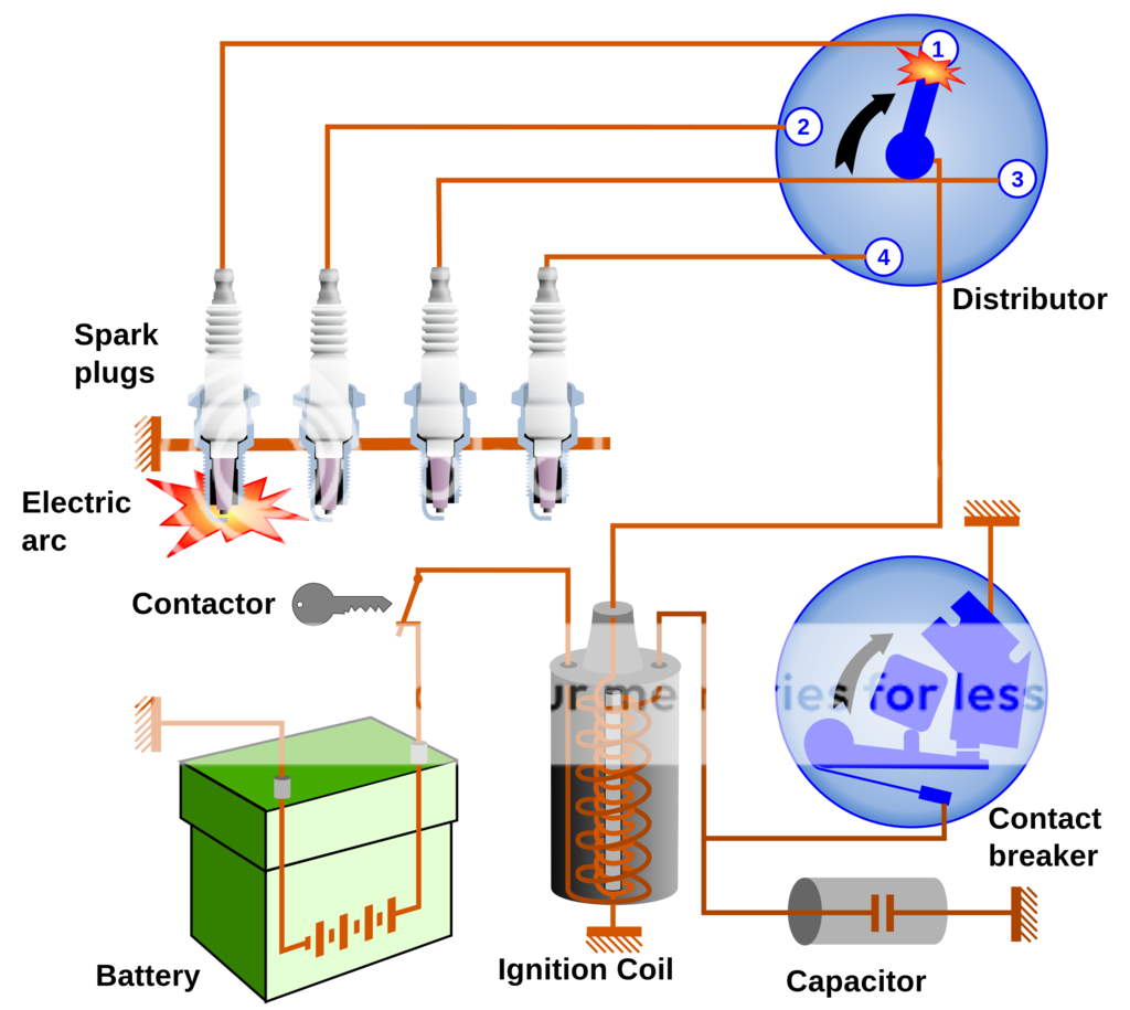

The silver canister in the pic is the condenser..........it is a capacitor actually. It looks newer, but it can fail. It is a very important part of older systems.
If you familiar with electrical and magnetic systems.........
When power is interrupted from the ignition coil the field collapses and this induces a current and basically is a feedback of spark.........pretty much a constant misfire issue. Removing it will make no change compared to when it is not working. Test it if you can........same as a capacitor ..or just replace it....cheap part.
When I first started working on it, this in the picture was attached to the ignition coil, in the 78 times I moved everything around I can't remember which side it was on +, or -. I do have a condenser in the distributor attached to the points. If it is a capacitor as stated by NCC1968 does it go on negative or positive side? Right now I am on negative side but above it was stated only the distributor cable should be on negative. Also is it called an ignition coil capacitor then?
Yes so it looks like it had one on the block inline (picture I posted) on the negative and also one in the distributor in both the original one I replaced and the replacement. So I have taken the one on the block out of the line. So now I just have the condenser in the distributor. Thank you for the diagram.
