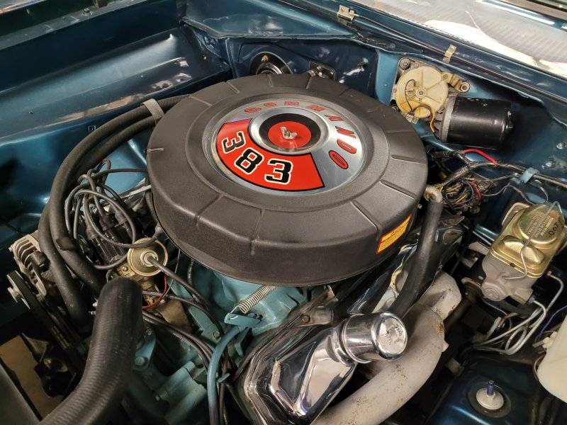

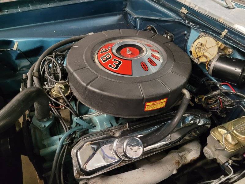

Good day!
I'm wracking my brain trying to find some information on the big-block unsilenced air cleaner I need to find for my '67 R/T.
1. Does anyone have OR even seen a '67 unsilenced air cleaner WITHOUT the little 90 degree C.A.P. nipple on the left side of the cover?
2. Is there a difference between '67 and '68 unsilenced air cleaner covers? I know the bases are different (4-1/8" versus 5-1/8").
Many thanks to those who are willing to share their knowledge on the subject.
I wish a Blessed thanksgiving to all. Kevin P

Yes, like I said it was a very early build, and was probably a leftover 67 piece. No nipple.
Some late year produced 67 dodge coronet R/T s came with unsilenced large air cleaners w/o the nipple. As they went into the 68 year some had the large unsilenced air cleaner to be changed by the smaller unsilenced as the model year progressed. I was also aware that some late built 67 Coronet R/T's came with the Carter AVS rather than the AFB. In the past Chrysler did some strange things. Hope this helps.

Thank you John. Yes this helps. Now I know the non-C.A.P. unsilenced exists so I'll keep on looking.
The 1967 parts book only has one part number for the big-block unsilenced cover. A and B body, 383 and 440, w/ or w/o C.A.P., w/o snorkel ...2863 986 which implies one cover (with a C.A.P. nipple) for all unsilenced covers with the non-C.A.P. cars getting a little rubber plug for the nipple. You see lots of those.
Kevin
My 67 Coronet R/ T 4-speed has the unsilenced large air cleaner without the nipple and a 4326S Carter AFB. May build date.
