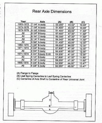

Hi does anyone know the exact length of a 1969 A12 dana 60 ? and are they the same length as a 1970 Dana 60? thanks for your help.
The 8 3/4 is the same width as the 68-70.....I would think the 60 would be too.
Axle flange to axle flange should be 60 1/8 inches, Cranky is right the 8 3/4 for those years have the same dimensions. Some may have 10.5 brakes while others I have seen have 11 inch. The scat pack was 3:54 ratio and the super scat Pack meant 4:10's. The spring perches should be 44 inches center to center. I pretty sure all B bodies from 66 to 70 have the same differential dimensions no matter what engine it had.
