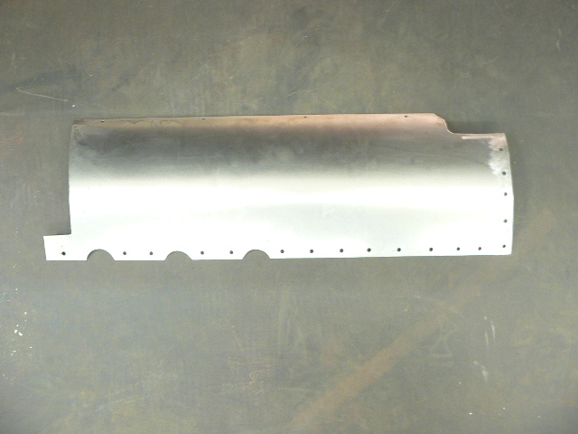

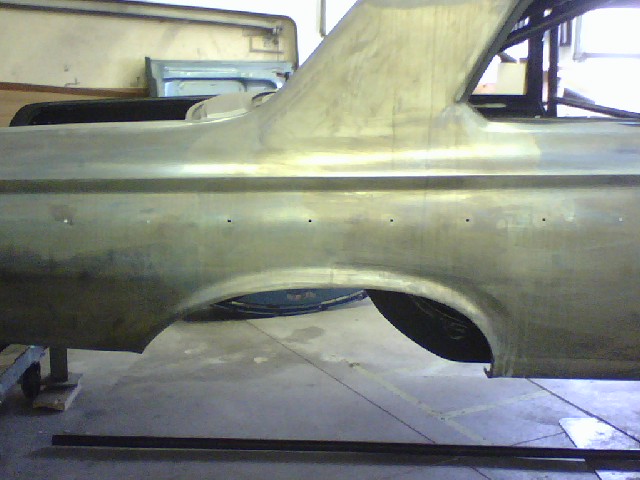

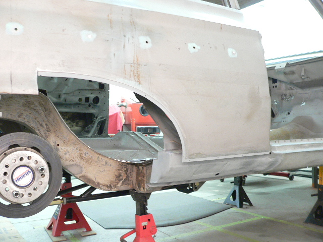

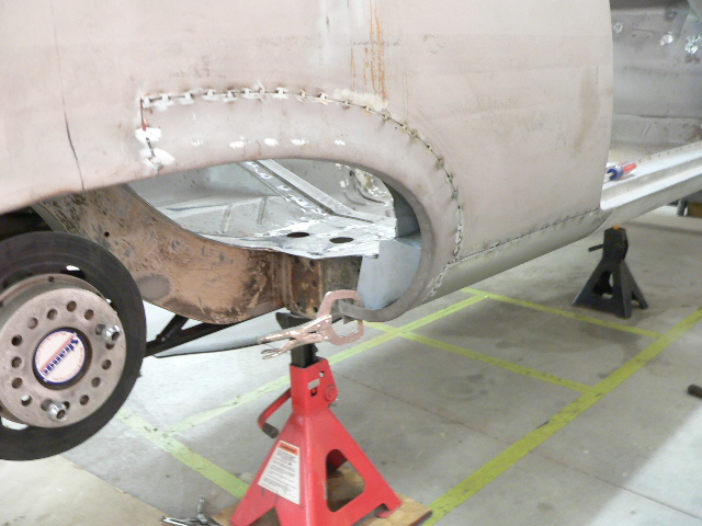

View attachment 120385Make your own. Piece of cake. Bend it over a 10" piece of PVC. Almost perfect contour.
