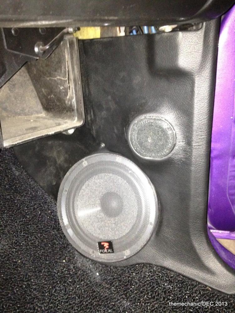

Nobody mass produces what you are looking for. Your best bet is to buy a pair of used kick panels and take them to a good custom car stereo shop and have them build you a custom set with quality speakers. Something like this:
What does the driver side (where it has to clear the parking brake pedal) look like?
