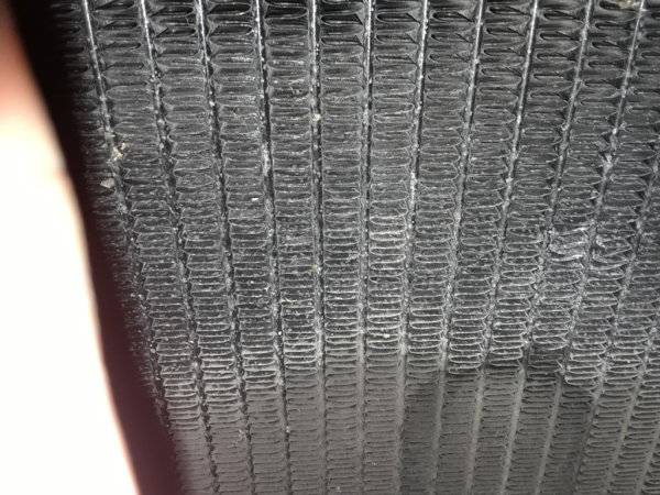

Hello All:

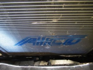

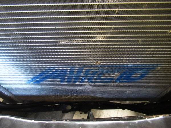

I have a Champion aluminum radiator which has sprung a minute pin hole leak near the front center. Small area that gets wet and discolored about the diameter of a dime.
Not many radiator shops left around Tucson, but I will call on Monday.
Any suggestions is appreciated.
It's definitely a seep in the core.

Here's a photo
Looks bigger than a dime sized leak to me. Look around and see what radiator shops are near you. They are still out there but not like they were 20 years ago.....

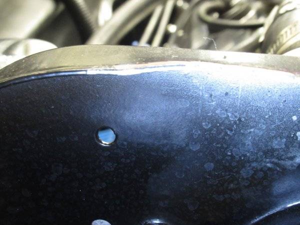

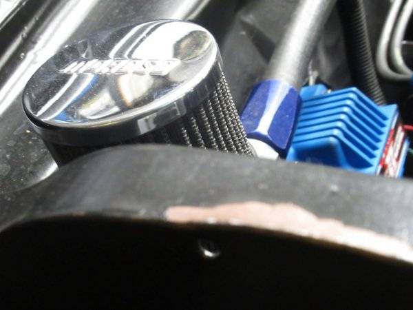

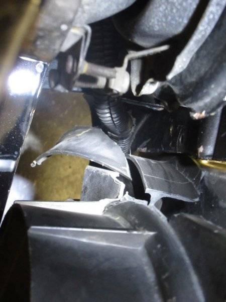

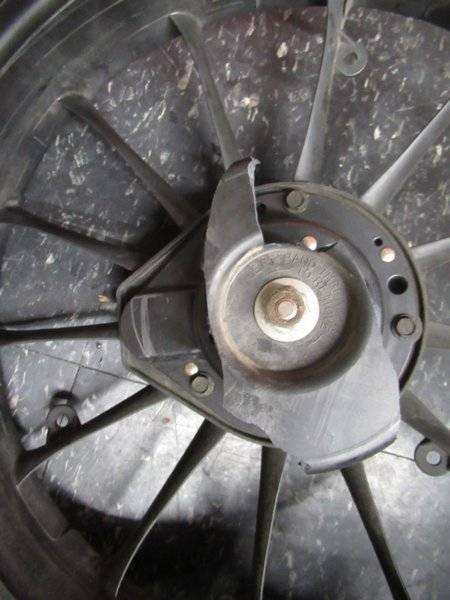

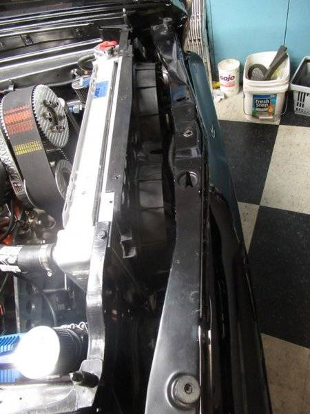

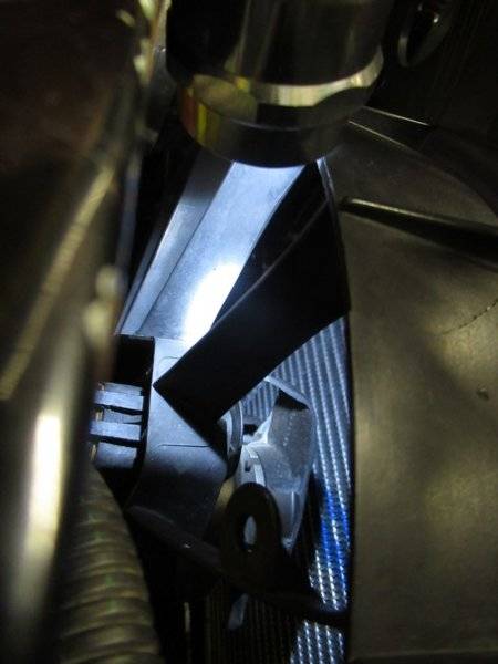

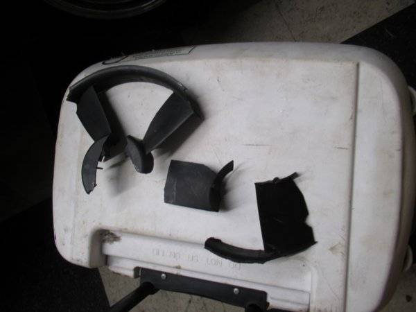

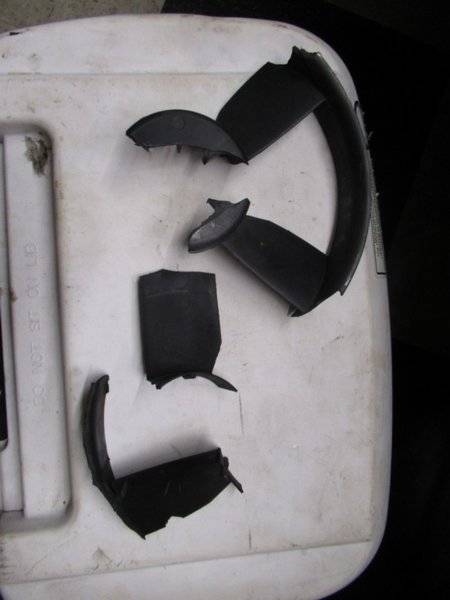

Have you been reading/listening?? I recently installed a $200 Afco aluminum radiator and used me old junkyard sourced dual fan set up and one of the plastic fans CENTRIFICALLY exploded dinging the rad support from underneath and putting a pinhole in my new rad.Maybe the 140 MPH wind had something to do with it.ANYWAY,some radiator stop leak and now dry as a bone!

I took the radiator to a shop that repairs mining vehicles radiators and diesel particulatics filters. They said easy to fix and cash price is $60.
I figure it's worth a shot for that amount. Should get it back Thursday.
The radiator shop called and they cannot find the leak. Even steam cleaned the radiator and pressurized to 30 psi and can't get it to leak.
He agrees that there is evidence of a leak, but says he won't fix it if he can't find the leak.
Ordering a new radiator.
Have had good luck with a 26” Mishimoto from Summit.
Well, just to close this thread with updates. The radiator shop guys were just so nice. They pressure tested the radiator three times, said no leaks, painted it, and gave it back to me 'no charge and no gaurentee'.
