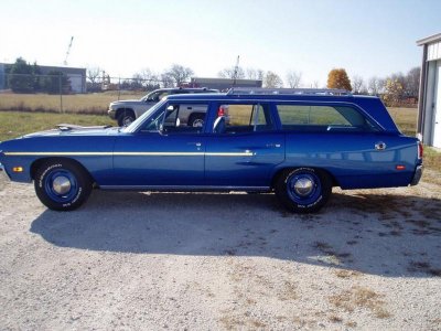

I have 15 inch steel rims on my 69RR and was wondering if there is a difference between 14/15 inch Dog Dish Hub Caps or are the all the same !!
Thanks Tom C.
Dog Dish
They are all the same!

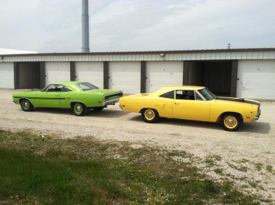

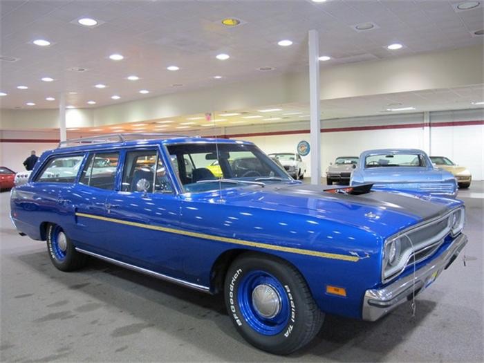

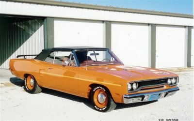

I have a sneaking suspicion those are all 15" rims but if the bolt pattern is the same, so to should be the shoulder that holds the dog dish.
Wanted to buy a set from a member in Indiana, and he wanted to know what was the measurement, of where the caps go on the rims.

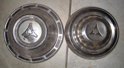

There ARE two different sized cop caps - the '66 - older and the '67 - newer. They are different diameter. The statement holds true that the cop caps will fit 13", 14" AND 15" wheels of the respective era. The big cop caps fit all of the early wheels, and the small cop caps fit the newer wheels. Except Imperial, which never had a provision for a cop cap, of which NO cop cap will fit them!
I was referring to the Plymouth Division or Dodge red circle style for 68 up from my experience.
I would like to respectively, clarify that the 67 on down used older, bigger caps and the 68 on up used the newer smaller ones. They differ by 1" in diameter.
The change came about in the 1967 model year. I've owned a couple of dozen '66 and '67 cars each to know this to be a fact. Check your factory parts manual - you will see different part numbers for the '66 and '67 wheels. The 1966 - earlier wheels (cars) use the larger caps; the 1967 and newer wheels (cars) use the smaller caps.
For example, the 1966 - 1968 Dodges use a very similar STYLE cap, but the '66 have the larger of that style, while the '67 and '68 have the smaller cap of that same style.
Left = '66. Right = '67 & '68. Size-wise, the larger cap is just over 10", and the smaller cap is right at 9" in diameter.
