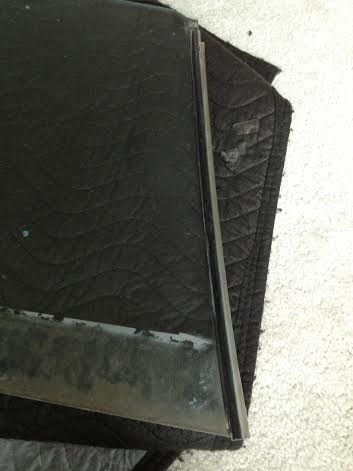

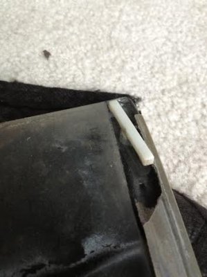

I got the quarter glass seals for the trim between the door glass and the quarter glass but where do I get the fuzzes that are installed with those small white t- clip? What's it even called? A window clip 2.jpgwindow clip.jpgttached pictures for ideas.
the T-bars I think I can reuse they seemed pretty nice and still hold tight but I need the fuzzy strip they hold in

My weather strips were in the same shape as yours. They are PN: 2932230. I ran the part number on Partsvoice.com and came up with a few vendors that have them yet. I know of no one reproducing them so they are spendy. I saw some on ebay for $200.00 for a pair of them. I bought a pair from Dave Smith Motors in Kellogg Idaho. They should have two left. Talk to Toni in parts. She said they list for $84.90 each but she sold me a pair for $60.75 each. About as cheap as you will find since most want between $80-100.00.
Their phone# is 800 635 8000 or 208 784 1208.
They come with the white plastic clips and the fuzzies. The fuzzies are about 6" longer than you need so you will have to cut them to size.
