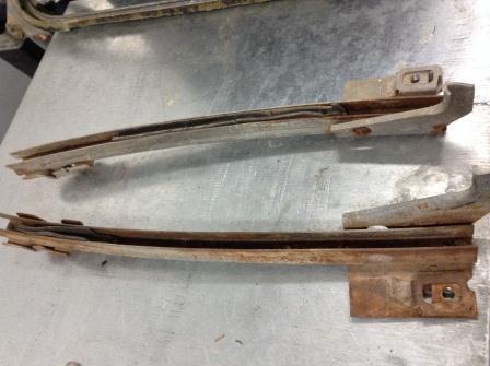

My son and I are restoring a 70 road runner sedan (post car) and need help finding this part. We have the fuzzy channel runs that go on the front of the door glass in the vent window frame, but need the rear channel run rubber or whatever material it was. Here is a picture of both left and right channels showing what looks like it was rubber that has long ago cracked and fallen out. Anyone have any suggestions?

That sure looks like what I need. Will order today, thanks alot!!!
Pretty sure this is what you are looking for. Just did mine on my post Bee.
http://www.megapartsusa.com/proddetail.asp?prod=159-AS2001&cat=85
The front of the glass in held in by a different piece which you will probably need too. The small white clips that hold in on are thicker than the originals and need to be sanded down a bit for the window to slide freely.
http://www.megapartsusa.com/proddetail.asp?prod=123-WS230
