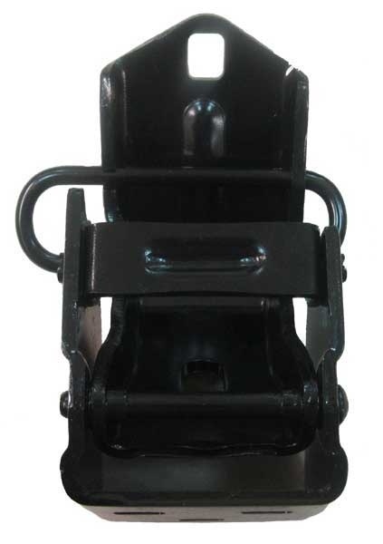

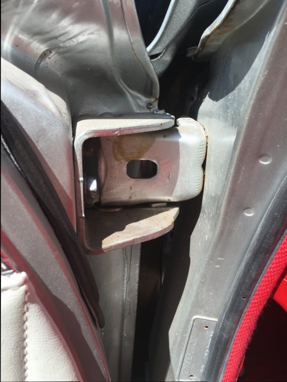

Need a top left door hinge for a 63 Dodge. One photo is the existing hinge and the other is the top hinge from AMD. Anybody know what gives here. They are very different.

If you get a chance please post a photo. My bottom one looks nothing like the photo either.
I will go out on a limb here..... is the reason you're replacing the hinges because the brash bushings and/or "pins" have worn away making the door "wobble" a little bit? I've rebuilt a few sets of hinges with this problem by welding the hole in the hinge & re-drilling it to exactly fit the O.D. of an Autozone hinge repair kit on a drill press. I've never figured out how to fix the "bottom cam-roller" on the lower hinge this easy.
Hanover Mopar. The AMD hinge looks correct to me, and is an upper hinge. The reason they look different is the original hinge appears to be missing the thick looped
rod looking piece that is part of what helps the door stay stationary when the door is opened all the way. I'm guessing that at present the door will not stay put when you do open it all the way, but will start to close on it's own. I'm having the same issues
