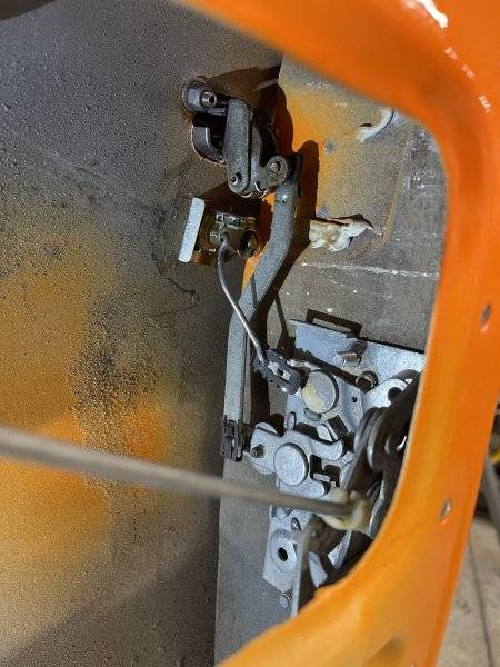

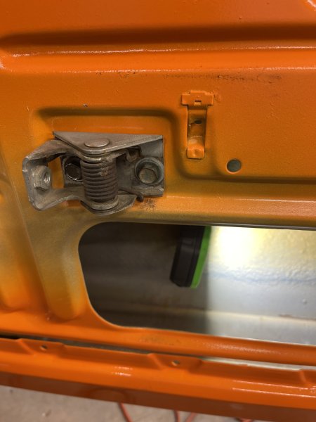

This is the area I am interested in seeing some pictures. How it attaches to the door.
I think I got as I move through it. Need to find the anti rattle clip.
I am not convinced there is an anti rattler clip in this assembly.

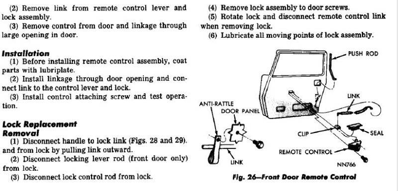

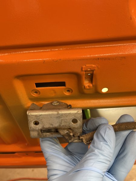

Is this the anti-rattle clip?

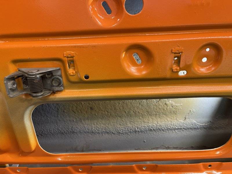

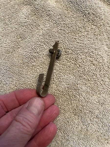

Expand the picture. See the Two dimples above the long rectangular access hole. Hanger goes inside to hold up rod and screw goes in the rear dimple to hold the hanger clip.

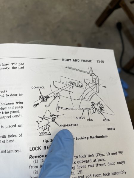

Thanks Wayne. This is where the FSM has flaws. People often tell me to look at the FSM. I do! It’s just not always clear and in this case not that accurate with this part.

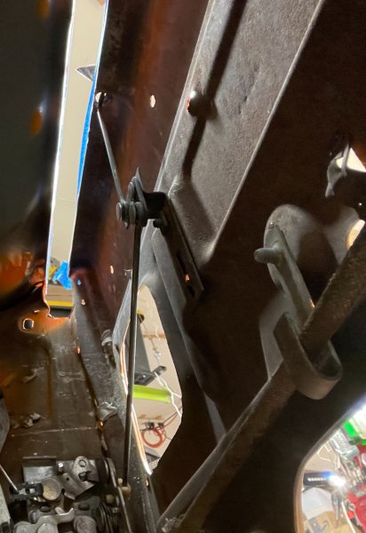

Awesome thanks for all the help guys!!
For posterity or something…
