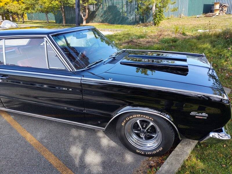

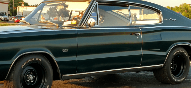

Ok , Gents . What is the difference ?
Or is there one.
I'm talking about the molding that runs along the top edge of the door
They are definitely different.
The charger is taller more square.
The Plymouth is more triangular with concave sides.
Don't know if you can see clearly in these pictures. I'm using my phone.
Don't know if you can see clearly in these pictures. I'm using my phone.View attachment 1049171
Ok thanks fellas. I dont have a 66 book handy to ck part numbers. I ve found an NOS moulding but seller says its charger.
Oh well, the search continues.
PS, good looking satellite. IS that red interior ?

Charger= 2586298/9
Satellite= 2586268/9
