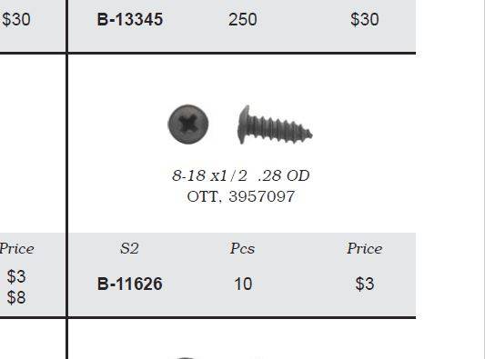

Any short low profile head #8 trim screw should work, originals looked like this. AMK Products, only drawback is they have a $30 min order.

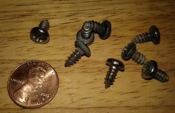

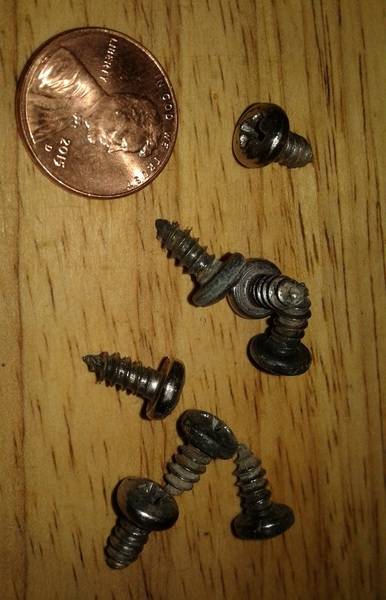

Let me check tomorrow on the screw situation. I know that we pack the Auveco 672 screw with the 71 to 74 E-Body outer door felts. I would think 1/2 inch would be almost too long.
The outer door felts were attached as I thought by the Auveco 672 screw. As mentioned above, a number 8 screw, but 3/8 inch long. How many do you need, I can send them out to you in a padded envelope as long as your here in the states. Just drop me an address on where to send them. The inners for the doors were attached with staples and the quarters clipped on. You probably could locate the screw at your local Ace Hardware, Lowes or Home Depot as well.

These were removed from a '73 Satellite outer door felt. Available if you need more after 69bfan helps you out.
