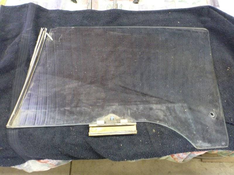

Post glass... has a big "leg" on it.

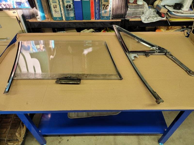

Hardtop glass.. is straight along the bottom.
