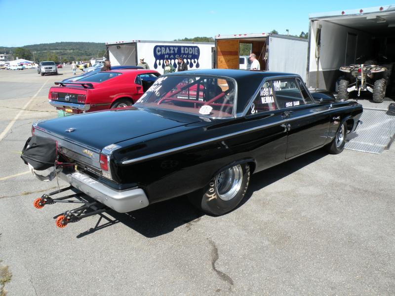

For the record my 65 dodge runs a 29.5 x10.5 non W hoosier and I hook all day.It makes 1245 hp.
But what do I know,I'm slow :icon_rolleyes:

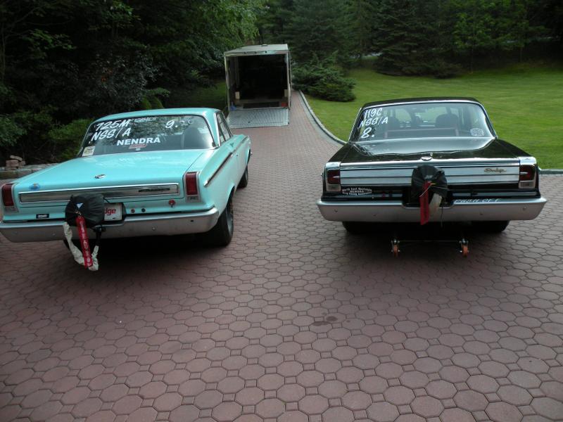

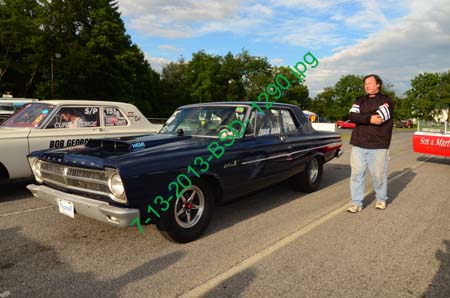

If you are concerned w/ ET, use the smallest tire you can hook, which at your power level, depending on gearing/converter, could be fairly small. Big tires take energy to translate and rotate, energy that could be used more efficiently to propel the car forward. Nothing is worse, IMO, than a big tire, slow car.
