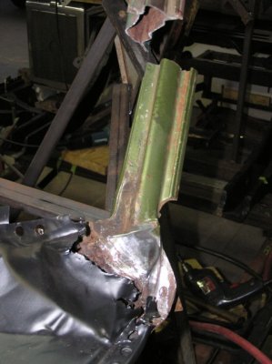

Is their a difference in the metal width of the drip rail, between a vinyl top and non vinyl top car?
My problem:
I am fixing my lower a-pillar by sectioning in an a-pillar from a donor car and there is a definite difference!

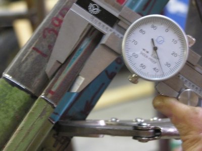

The blue upper piece .335 is from a vinyl top car.
The green sectioned in piece .350 is from a donor car that I have no idea what it had? Maybe the non vinyl cars were thicker?
I think I can grind down or blend in the difference so it would not be noticeable.
But is this going to give me problems down the road, if I put a vinyl top on?
I don't know what to do about this?

i agree with Donny, just make it work, a little massaging and ingenuity can make it perfect. have you ever looked that close at drip rails on other cars? I think not. just feel good about have a donor part!
