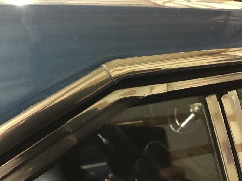

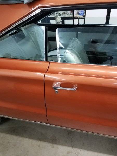

Hook the top part first then pop them on. The lower portion clamps around the bottom of the drip rail. Start with the front A pillar one then top then rear. The 2 angled pieces will cover the gaps.
The proper order is the rear angled one first, then the one above the door, because it overlaps the rear piece. Then the front piece on the windshield pillar. The one small angled piece covers the ends of these front 2 pieces at the corner.
Put it on the top edge and roll it over with your hands. Some spray lube won’t hurt anything..
Yea I just took them off the other car I guess I thought there was a little cover for that piece over the quarter window :realcrazy:. .. But you are correct start from the rear.
