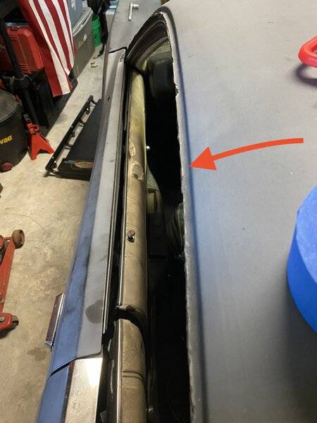

Hoping someone can offer some guidance. I have searched the forum and the interwebs and found some information, but nothing definitive.
I have a 72 Charger SE. The PO cut off the driver side drip rail support, and I want to put a new one on. I can't find a source for that says for sure it will fit this car. It seems that maybe the drip rail supports were the same for several years/models, but this is the first Mopar of this generation that I have dealt with on this.
I also assume the drip rail support is spot welded to the roof support like other vehicles of the era. I need to pull off some trim and stuff to take a look at it to verify that.

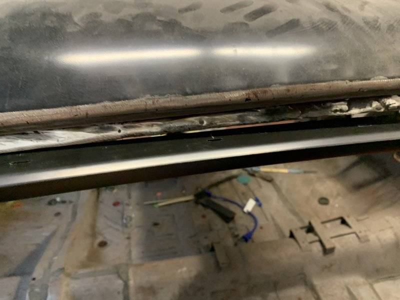

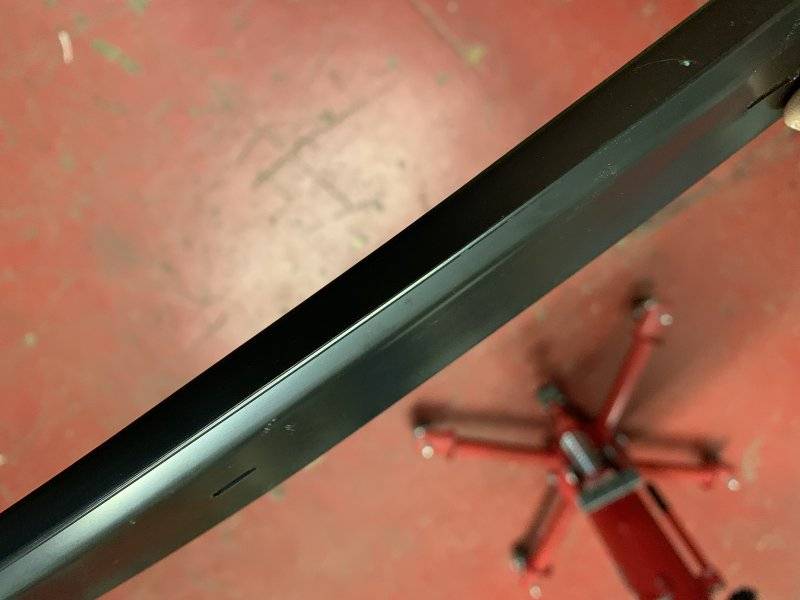

It’s a bit different than that. The drip rail is part of a thicker piece that attaches to the pinch weld inside the weather strip holder. I can show a pick tomorrow, but I assume they are not available for that year?

Sorry it took so long. Here’s some pics. Because they are not available for you year, you probably need to get some of it from a junk. You may not need all of it if you are good at welding.
I can weld, but I’m not sure I would say it is “good”
