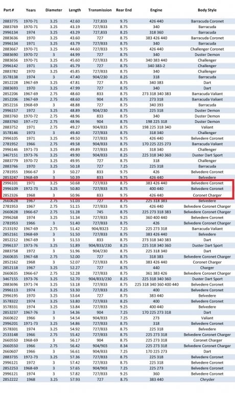

Looking for a driveshaft 50 3/4 inches yoke center to center. Apparantly this is the approx length as the shafts in 1966-1973 Belvedere Coronet Satellite Road Runner GTX with 383,400,426,440 motors. Rear end is an 8 3/4 and the tranny is a 727.

I just used this chart,
I have one from a 1968 Coronet 318 with 8-3/4 rear end. Will that work? I can measure the drive shaft, it's still on the car but I'd thought I would post here first.
Best bet is to measure, I was just using this chart but I'm not too sure about it...
