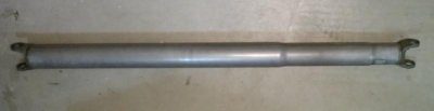

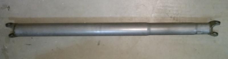

I sent out my drive shaft to get checked for balance and true, and they called me today saying that the yoke on one end needed replaced because the u-joints don't seat properly. anyway the end he mentioned was the wide end of the drive shaft and he stated that is the end that goes to the transmission side. My drive shaft has always been installed with the narrow end of the drive shaft at the transmission.
My question, which is correct orientation for the drive shaft, narrow or wide end at the transmission?
Here is what it looks like.
The narrower side to the REAR, when both sides are swedged the longer section of swedge shaft to the REAR

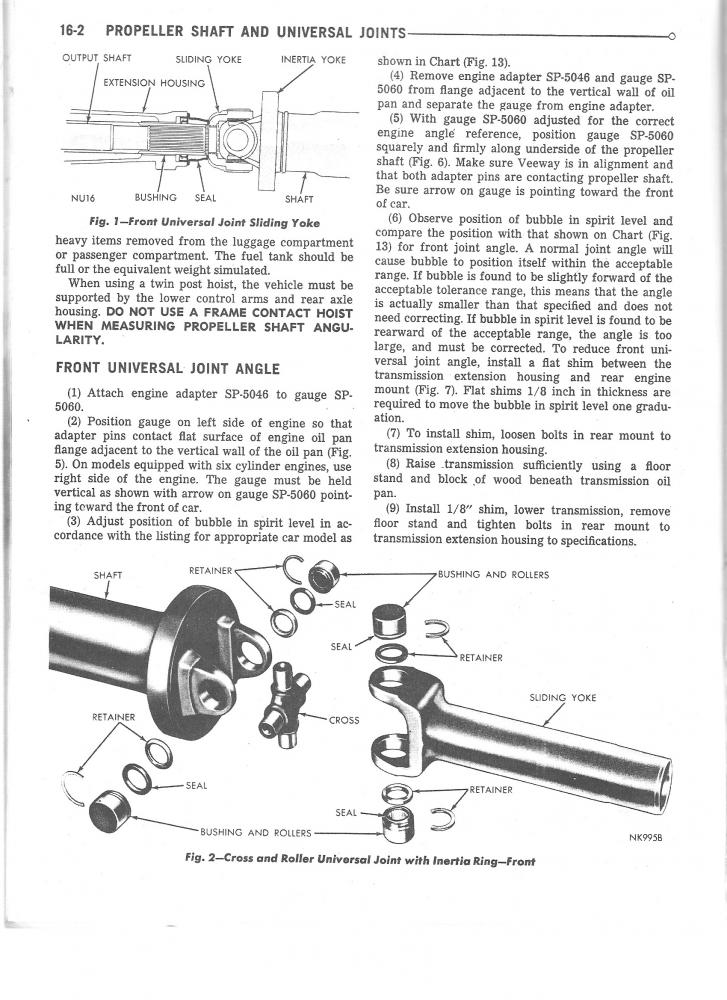

Yea, I agree that Super knows, and I also agree that I never really paid much attention myself. Here is a pic of the inertia ring I am talking about.

The old detroit inertia ring shaft was used in some cars thruout the years, that is not a balanced weight though, the shaft still needs to be balanced.

The inertia ring acts like a flywheel, it makes the driveshaft require less energy to keep it spinning at the same speed. It is not for balance, although it could plausibly absorb some of the harmonic energy in its mass.

When you said weight it didn't click you were actually talking about the inertia ring. That is used to damp torsional vibrations through the drive train.
