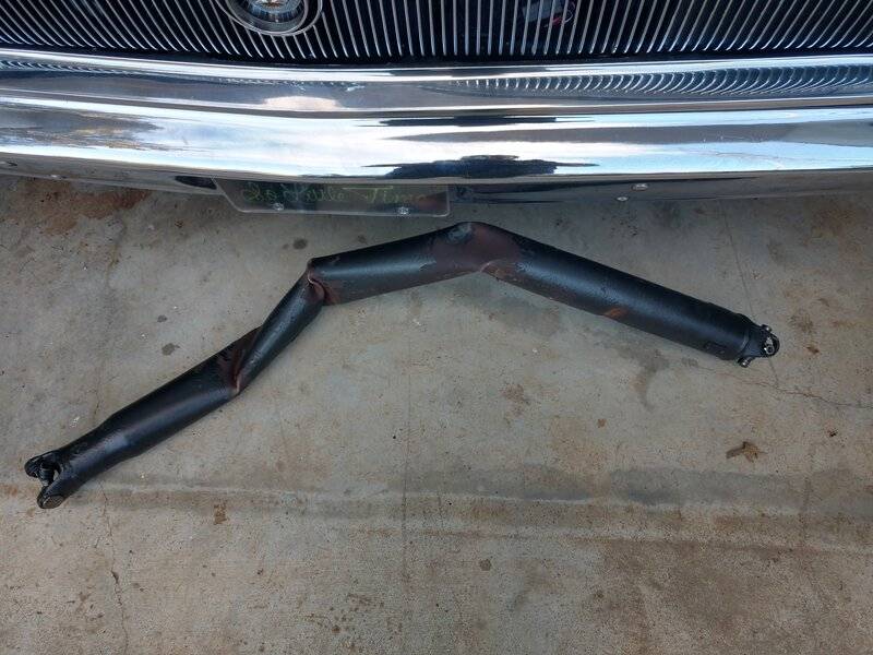

A new driveshaft is cheap insurance and I will never run a factory driveshaft again
