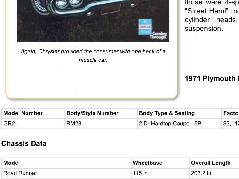

Both vehicles are 117 inches for wheelbase.
No, they ain’t
This should be easy. The 383 and 727 will drop right without modification and sit where where they should as factory engineered. As said, the 71 RR wheelbase is 2 inches shorter so take the driveshaft to a driveshaft shop and have it shortened that much. They will probably want to have you give them a measurement from the car with the engine/trans and axle installed just to be sure of the dimension. The driveshaft shop will rebalance the driveshaft after it is shortened.

What potential hazards would exist if the driveshaft is 1/2 an inch too short? At the moment the driveshaft is seated with what appears to be excellent spline engagement....no wobble whatsoever.
At ride height or hanging rear end. If the rear is hanging it is into the trans the furthest
