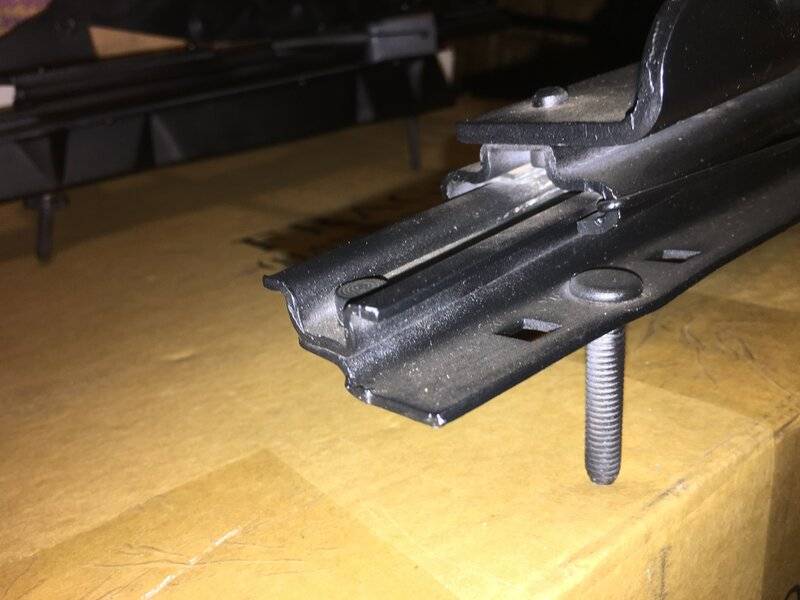

Look at the bottoms of the seat frames. There are usually a series of holes that you can switch the mounting bolts into. These would be the holes closest to the floor, not the ones that attach to the seat base.
If the seat cushions are original, that can make a big difference. I'm short and if the seats have worn out foam, it means I am sitting a few inches farther back. I'm glad Stanton posted that info about the tracks. I'll do that in future cars or next time the seats are out.
