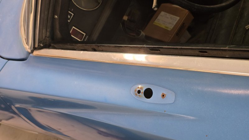

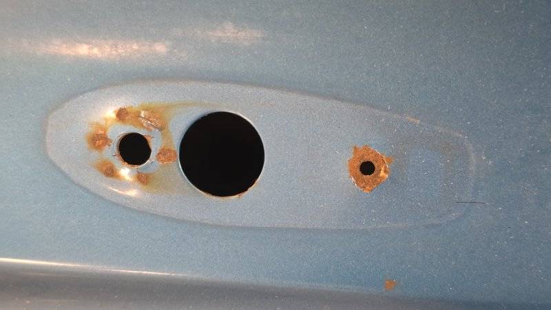

I am seeing two different mounting styles on 67-70 B Body. One style is, looking front to back, mounting stud then control cables then sheet metal mounting screw. The other style is control cable then mounting stud then sheet metal mounting screw. Has anyone seen the difference I am describing in the outside remote mirror mounting? Thanks Jim

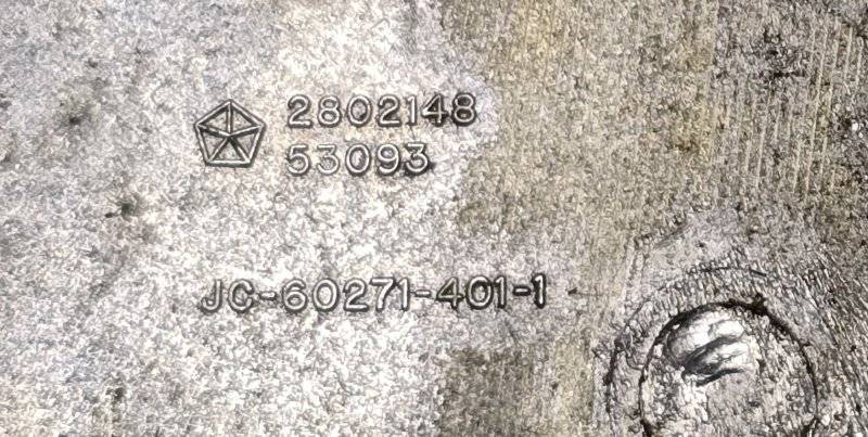

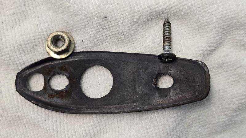

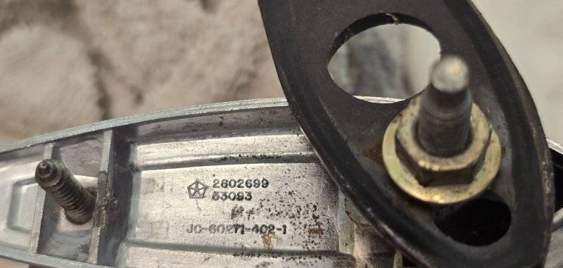

The original driver's door and manual mirror on my 1970 Charger.
Mirror base:
2802699
53093
JC-60271-402-1
Mirror dish/housing:
2802148
53093
JC-60271-401-1

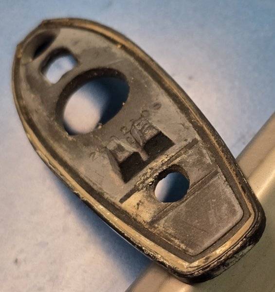

Note the two sides of the gasket are not the same.
I'll post an update as soon as I find the OEM remote control mirror I bought in the late 1980's.

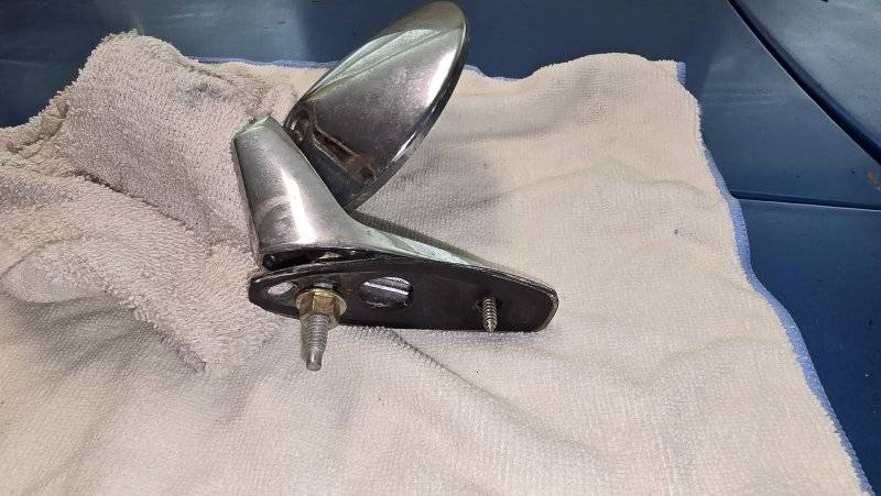

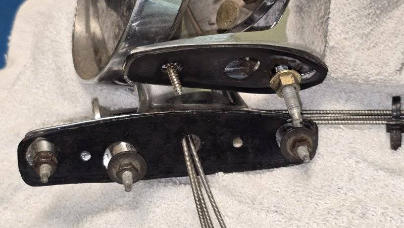

@Daytona Jim

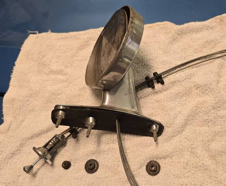

Pictured below is the driver's remote and it supposedly came off of another 1970 Charger. I do not know if that is true.
Obviously, this remote mirror mounting is totally different than the non-remote on my 1970 Charger.

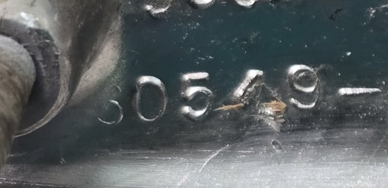

3796634
53093
The first digit in the bottom numbering is difficult to read.
30549-401 First digit is a "3"?
50549-401 First digit is a "5"?
60549-401 First digit is a "6"?
Close-up:
Bonus picture:
:p

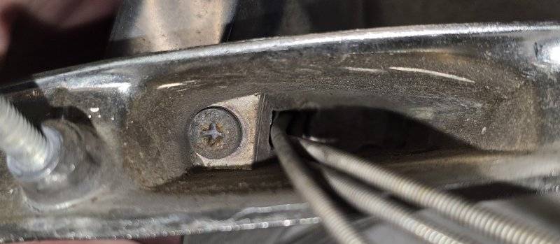

The screw pictured above secures the round mirror housing to the pedestal base.

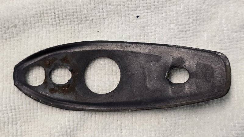

@Daytona Jim

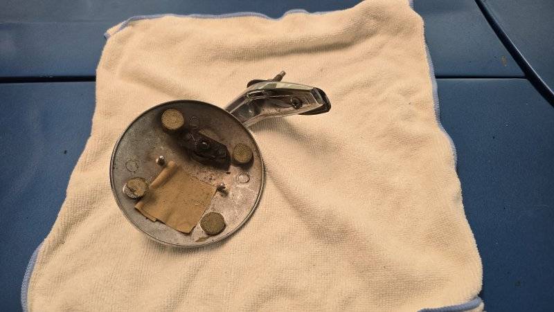

Side-by-side comparison of the two mirror bases.
Also, the round housing for the remote mirror is noticeably larger in diameter.
4-7/8" outside diameter of remote housing.
4-1/2" outside diameter of manual housing.
