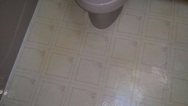

The coal tar atoms are so small, they penetrate Everything! Not a believer? look at the Pic of my
main bathroom floor on either side of my toilet. Guests come over and hell, you can't tell them all
to take their shoes off. Can you? Well, We didn't. After 15 years it's time to change the flooring!
^^^ I would love to know what brand or how they are mixing that sealer to do that. We only would use Neyra "Tarconite". They only time we would possibly see any tracking would be if it was very humid and someone opened up a lot before 24 hours. You need a different sealcoater!.[ and floor]lol.
