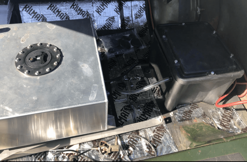

Yes I'm going to do that soon. I am going to be removing that fuel cell and reinstalling the factory tank today. I can't find the ground wire to the gas gauge so I need to find a new one as I don't feel comfortable driving 500 miles without a working gas gauge.
