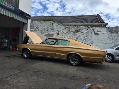

In studying the picture of your car, alextucker, the ride height in back doesn't look bad to me. Was the car full of gas (or at least a half tank) when you took the picture? If so I'd just leave it alone because the back will come up when the gas gets used up and the car picks up nose weight.
Wow loads of options , many thanks guys, yeah it was on a full tank Vegiguy with some boot filler so I'll look again when it has a skinny day.
They just look so flat when the car is in the air that I thought I better do something about them. Re-arching or replacing sounds like the best way to go if I can't live with the lower height, gonna be a tough job over this side of the pond though, is air shocks a big job or just direct replacement?

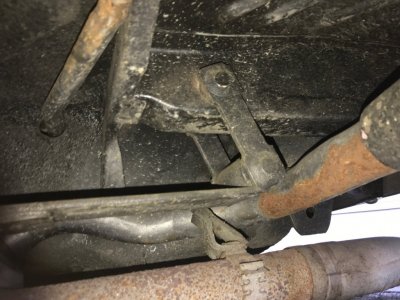

upon further inspection I see the angle of the retaining bushing holder, does this look correct as I'm surprised at the angle?

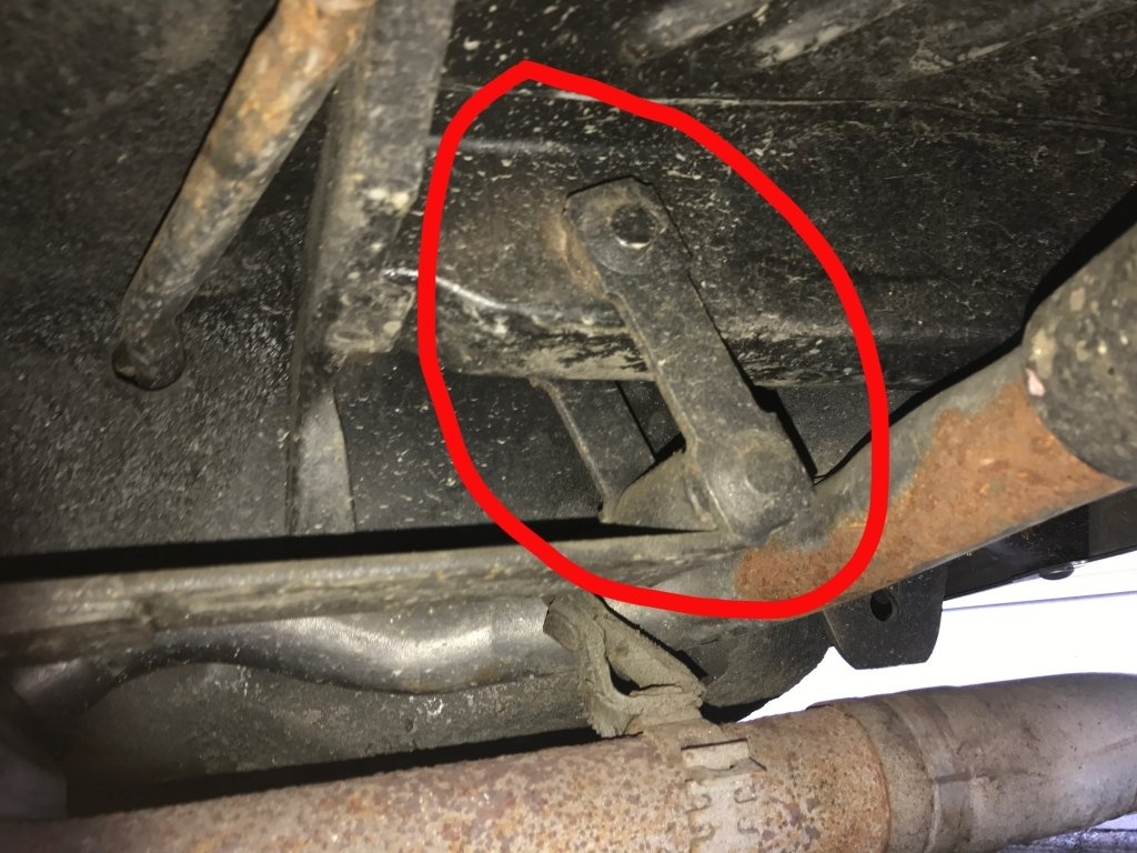

Love a good disclaimer! ... and the more I take on board what you have experienced the more I don't think I need new leafs.
I was more questioning the angle of the bit I have circled in red, not sure the professional name, something cool no doubt, I am thinking that this should be more vertical which would bring the rear end up?
