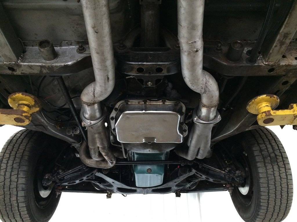

I dropped the 3” headpipe and 3” 50 series Flowmaster off the Coronet
Left the tailpipes hanging there

Two tenths and two mph is roughly what we pick up dropping the exhaust on my '69 496 Road Runner. Haven't tried it with the new motor yet, but that improvement should put me into the ten's! Time will tell.
A part of me was hoping there wasnt going to be any real change. I still street drive it, and can't with open exhaust.
So i'm looking at better flowing mufflers. And perhaps a 3-1/2" headpipe leading to the mufflers?
Electric cutouts open it up at will...
