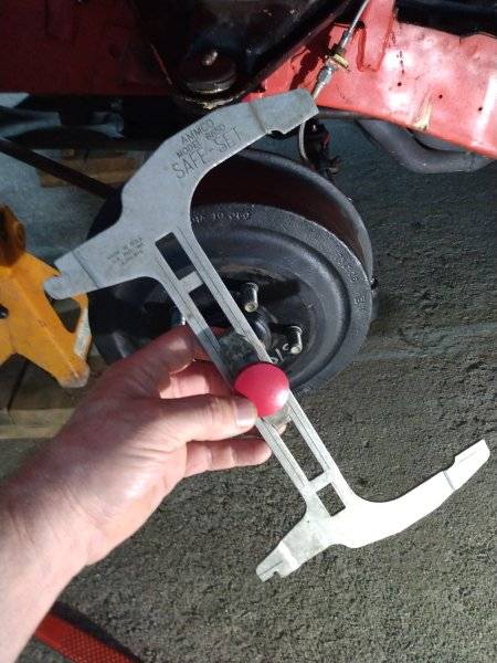

Anyone else use one of these, to get things close before you throw the drum on?
