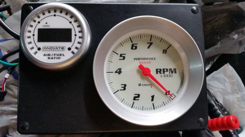

Yes I have one on my Hemi crossram it did help me tune it but I have gone through a couple of O2 sensors.
Here's the picture
It constantly changes with accelerator position. You want 12.5 AFR at wide open throttle and somewhere around 13.5 AFR at idle and cruise. It is possible to go a little higher at idle and cruise but you want to make sure your engine is not pinging. That can be catastrophic.
