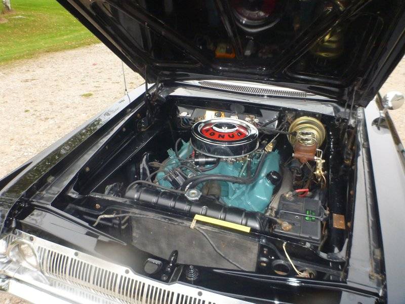

Working on doing the same on my '65 Satellite. Unfortunately Dr. Diff is out of stock.
