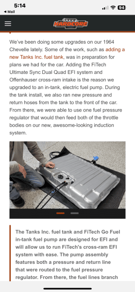

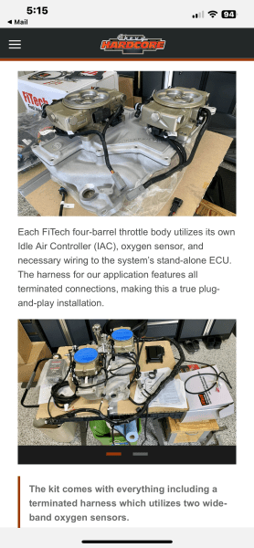

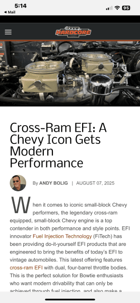

Cool Article on A New Cross Ram
FiTech Kit !
Yeah I know it’s A Chevy Small Block
Build Article, But Those In The Know Are
Aware of The Similarities.
IMO The FiTech Setup Certainly Could Be
Installed On Any CrossRam OR Dual
Quad Intake Available To Us !!
Why Not !
