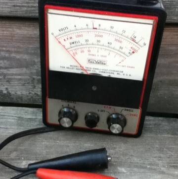

This is the one...Fox Valley.

Yes, sir. It works fine, switched to ohms, nada on dwell. btw, that photo is not mine, just one off the 'net'.
