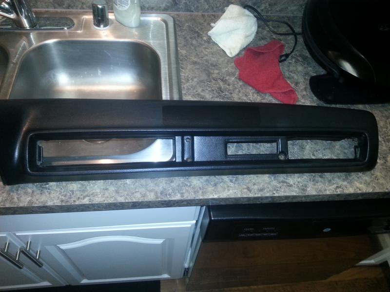

I found an original 72 dash pad in great shape but someone had a sticker on it and it faded around it. Has anyone ever used vynal paint or any other methods to to fix that problem. Woul 250 be a good price? I appreciate any feedback.

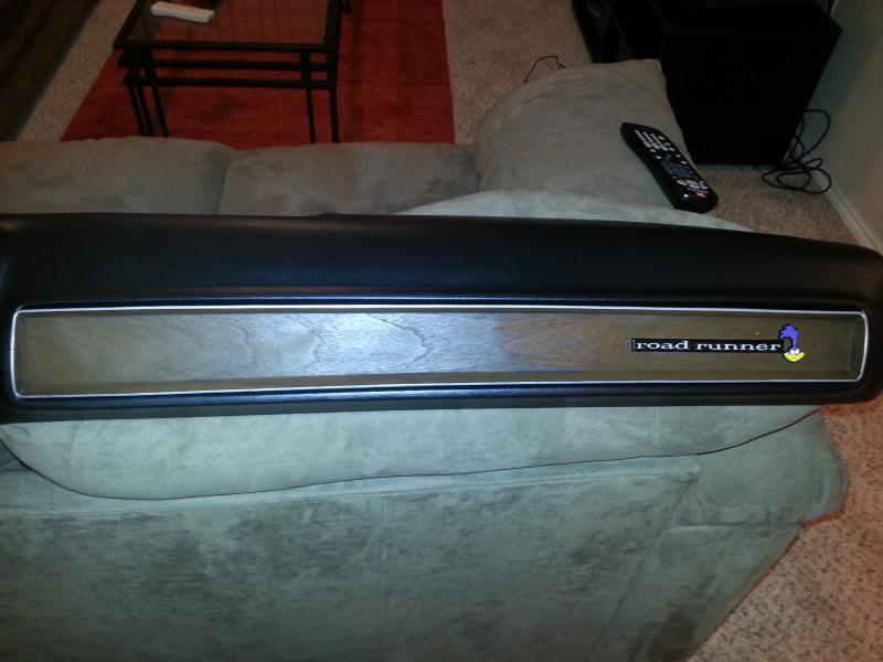

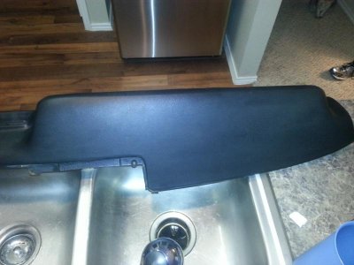

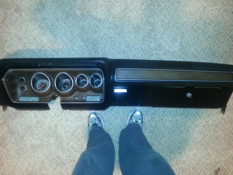

So here is the part that needs to be fixed. I am going to get the SEM vinyl paint and wait a while for the weather to get warm and PRAY I do not bleep it up. Overall, this is not bad at all for an original dash pad. I was so happy with how my dash turned out so far, I had to post a pic.
Hell yeah that's one good lookin' dash! And the pads don't look too bad at all. The colorcoat should go just fine, I wouldn't even be worried
:eek:ccasion14:

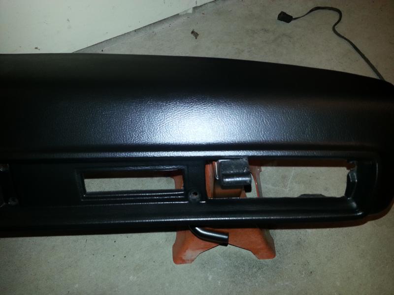

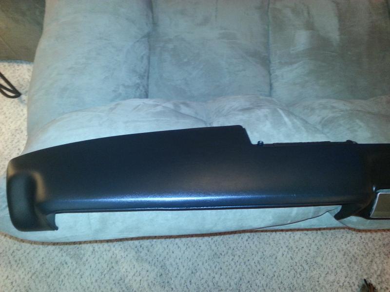

Guys, I can say enough how thankful I am for your help. Its looks brand new again and for a fraction of the cost for repop. the people on this fprun rock!
