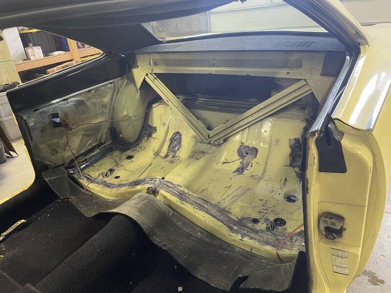

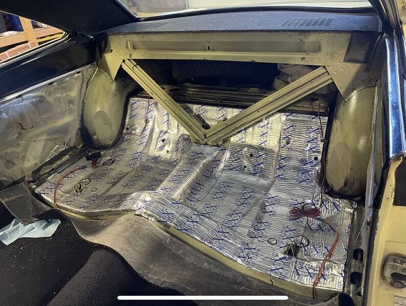

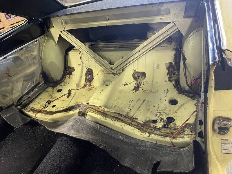

I bought this to do the interior of my Jeep JKU. I had a lot left over and now I’m doing my 68 Satellite. I have some surface rust under the carpet, so I’m degreasing, then cleaning with mineral spirits, then painting 2 coats of rust converter and finally the mat. I’ll let you know if it works. Yes....spray liner would be easier but this costs me nothing but time. I had all the stuff already. Also if I get rust from the underneath, I can pull it up to do welding/repairs.

I'd suggest a finish coat of some sort over the rust converter - like primer, you don't want to leave it bare because it can/will hold moisture. It can't tell the difference between moisture and paint...all it knows is, it's designed to hold on to it.
Good point. I’ll do that on the front part as I already did the rear. The front has some deep rust and areas to repair too.

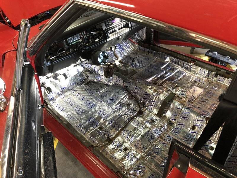

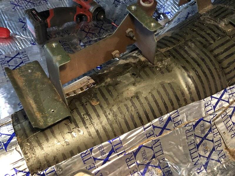

Drawbacks? Removal may not be so easy if you ever need to do so. I used "Fat Mat-Rattle Trap" for my '70 Charger. I had to peel some up recently to do some floor modifications for the 5 speed swap I'm doing and I expected the sheets to be a bear to remove. They were a lot easier to pull up than I thought.
I used the same Rattle Trap as Greg. Installed it on the floors, C pillars, roof, and inside the doors. It definitely helps muffle some of exhaust noise.
