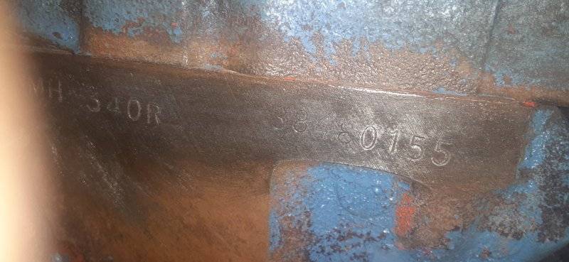

The bad: While I'm quite pleased that it is a steel crank 340, it is my belief that Road Runners should have big block motors. But that's just me. The car from day one had a bit of an engine miss. At an idle it sounded like a possible cammed motor and would smoothed out on light acceleration. Under a load, it sounded like my tractor. This took me a minute to figure out. Spark to all 8 and the timing was not crazy out-a-whack. Hmm? Time to gather evidence. Engine bay painted black :(, lots of blue over-spray :(, a radiator big enough to cool a Kenworth, and look at that, the cap actually hits the HOOD! :cursin: WTF? Some acetone and a wire brush... not a G-code 318, but instead an MH 340R 38480155 stamping.
Not bad but now paint and motor don't match. Still got an engine miss. Time for the K-Y and a scope. Well, well, well, seams to be a 30 stamped on all 8 pistons and #4 is oily as an Alaskan harbor. Not showing on the plugs though... Their new. Time to pull some bolts. Found bits of hard plastic in the rocker areas. Pulled the intake (casting say it's a 1970 4 barrel) all sorts of plastic pieces in the valley. Was told by members that it looks like valve seals. That explains #4. Now I'm pretty sure Bubba slapped an old 340 together with some laying around parts to remedy the old 318. I say this because the rest of the car does not resemble what took place in the engine bay.

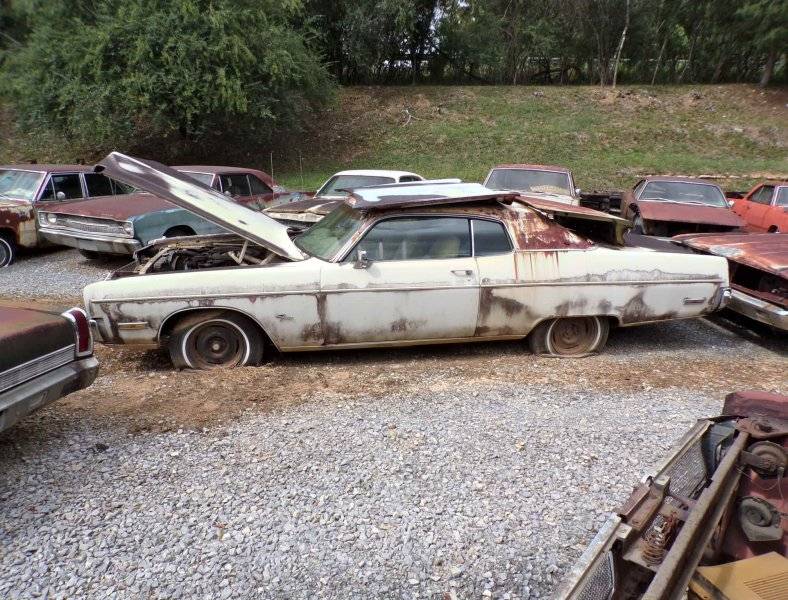

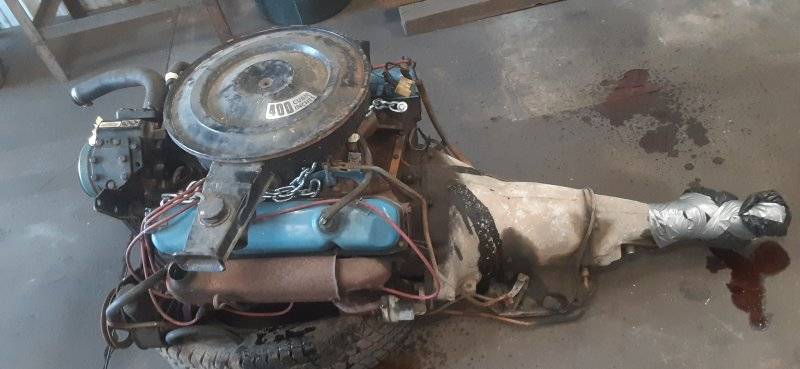

The motor in the photo is a 400 with the legendary 727TF. The donor car was (is?) a 1973 Fury. The vehicle belonged to a fella in GA. He said it was his father's car and he got it 20 yrs or so ago. Moved it around a few times but it hasn't been started in years. Crank turns and he thinks with some fuel and effort it would fire up again. Still had all the fluids in it. A lot of them came out in the back of my truck on the journey home. Nice SMH.

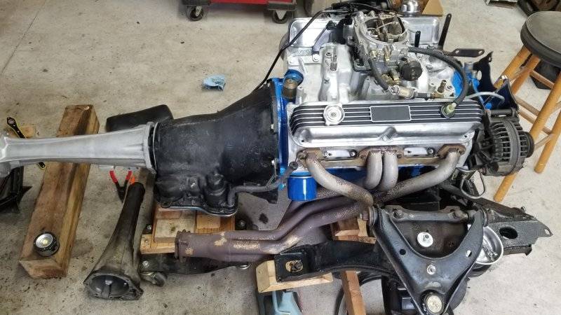

Been a minute. So here's where I'm at with the elephant. First, yes @ckessel if it was bolted to the motor I got it. Alt brackets, a/c, p.s. let's see, what else. I took everything but the radiator and condenser, hell I even got the driveline. Now I won't have to count splines, 3 times and get a different number each time. SHARPIE!:lol:

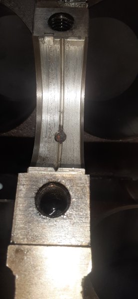

They're all Keltec bearings... no wait that's my 32. They're all Clevite .010 bearings, what's left of them. On the up side none of them were spun. This is # 5 & 6 but you can see the aluminum-bronze in the others also. #5 is much better than it should have been, see next photo.
I don't know if y'all can make it out, but the oil passage on #5 is completely blocked.
I was able to get a small piece out with a pick. It was steel from somewhere. Had to use a .0625 bit and drill the other piece, then insert a tinny screw to pull it out. Oddly it was a chunk of lead. Things that make you go "Hmmm". No, there are no bullet hole in the motor. Found other small pieces of steel around the crank area while tearing it down.

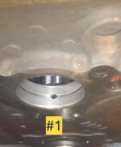

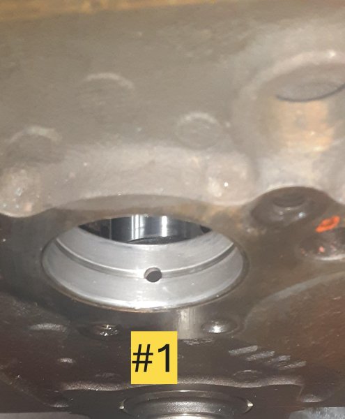

So I set the cam on the bench and come back to inspect. Tear Down 1 Cam Bearings copy.JPG Well, well, well isn’t that special. All the bearings are wore slap out, and some have chunks missing, and the center oil passage on the #5 is plugged slam up. Tear Down 2 Cam Bearings copy.JPG Gee, that’s great. I luv working on old stuff, especially old stuff that Buba slapped together out back underneath the fkn tree. I spent the next 36 hrs trying to convince myself that I didn’t need to tear the motor all the way down and wondering why I left that supervisors position. With the bank I made there I could’ve paid somebody to do this. Where’s the fun in that though.? All I wanted to do is put the motor back together and a quick overhaul with a shift kit in the 904. Put it all back in and take my wife for a ride. That’s all.

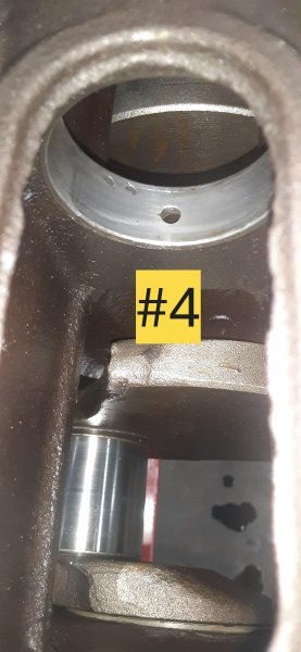

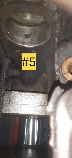

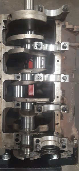

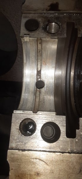

HOLD THE PHONE HANA!! WHAT IN THE CRISPY CREAM BLUE HELL! Tear Down 18 Mains.jpg These are as scared up as Sigman and Froyd after their last show in Vegas. Tear Down 20 Mains #5.jpg #5 took the worst of it, but #4’s oil passage is plugged up tighter than a prom date. I’m sure it would have been on it’s way out soon. Tear Down 21 Mains #4.jpg I should have figured this out after cleaning out the oil pick-up screen. It was really bad. SMH This motor was living on barrowed time. Who knows how long it would have gone before major or even catastrophic failure. So, I guess this is a blessing?... finding it now. If ? it can be repaired.
The block and crank are now at the machine shop. I’m waiting to hear back from him. Hopefully it is good news. I don’t know though; the crank was already 10 under. I’ll know after Christmas. Been a while since I was this worried about being on Santa’s naughty list. How many good things did I do this year? :rolleyes: Won’t be taking off my boots to get to that number. Need to work on that for next year. The 400 just got kicked into the corner on a-count-a I got rob Peter to pay Paul. Stay tuned, there’s a lot more of this elephant to eat.
