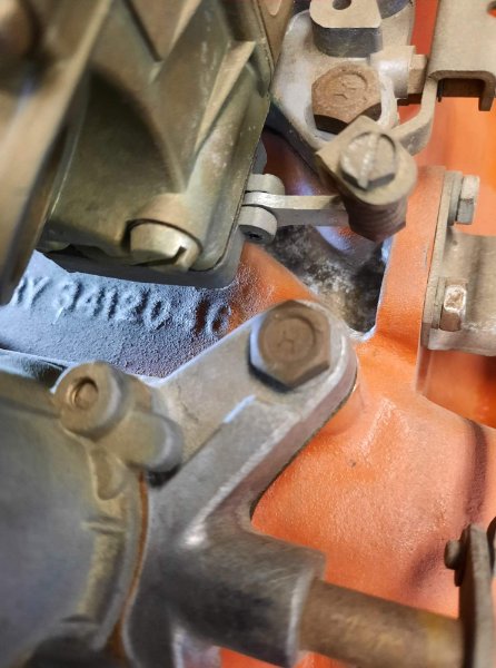

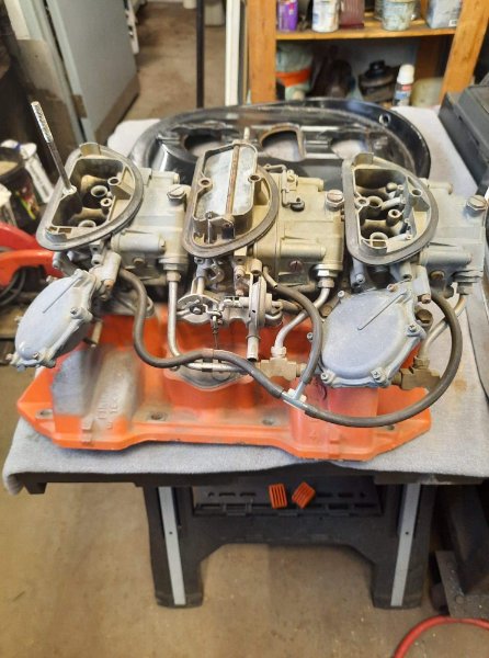

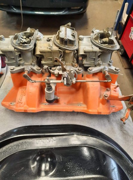

Hello people
I am cleaning out my storage and found my 6 pack, and again, going through my notes, I can't get a yes or no answer if mine is an actual 1969.5 A12 part ...
Bit of a back story, this 6 pack setup was removed from a car in 1984, wrapped in plastic, then stored in a closet for 40 years. This is important to me (my story) because it was a friend that bought it in 84, before "numbers" meant anything and muscle cars were just cars, and I can vouch he did nothing but dust it off. Nobody after 84 touched anything on it. About 10 years ago, when I finally convinced him to sell it to me - I had a 1969 SuperB - at that time I sent a member some pictures, it was internet confirmed it had all correct hardware and the numbers on the carbs are correct for A12 but I couldn't get a clear answer if the intake was factory installed, over the counter dealer, or from a parts outlet ... its all about the "6". So this is what I got, if someone could be so kind and shead light on this.
THE PICTURES DON'T SHOW THE RIGHT ANGLE BUT, the 6 is actually lower and tilted to 1-2 o'clock. In person it is very obvious. I did not want to remove a carb just to take a picture. The posts I have found on various groups talk/show the 6 is crooked but has a tail on the top, mine is not like this, but the 6 is definitely...gimped. Edit: after closer look, the 6 is normal not crooked, just more pronounced then the other numbers.
So that's the scoop, is it a A12 intake ? And maybe even more importantly, does it matter if it is or is not ? Consensus among my friends is that even if it is, there are so few A12's and even fewer A12's that need a 6 pack that it makes no difference, it will never find its original home on a A12. Long story, but if it is a oem part, I would love for it to go back on one.
I am on the way to dig this out of storage and bring it to a Mopar expert in my area, take some pictures. These pics are 10 years old, its when I got it.
I would love to hear you ideas on this.
Thanks Frank
Imho. Who cares. Put it on something and run it already after 40 years....
Have you got the date codes and list #s of the carbs? That would be the first thing I would check when you get your hands on em again.
If the carbs are legit, the chances of the manifold being legit become very very good!.(if I remember right, there are different list #s for the center carb, depending on if auto or four speed.
If you need I can get the numbers off my second day A12 stuff.
