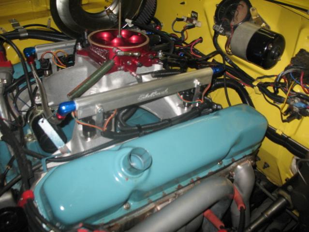

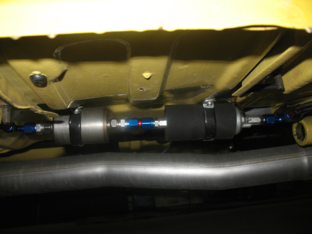

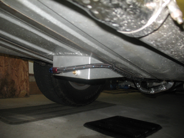

I have the Fast EZ 1.0, version 2.0 was not out at the time I purchased my kit.Upgraded to multi port injection, being an EFI novice follow the instructions closely and should not have any problems. Some stalling experienced but corrected after driving some miles and tweaking with the handheld to find what the engine tune likes.I,m happy with the set-up.
I,m going to add make sure your charging system and wiring can handle the added load from EFI,fuel pump,MSD etc and supply the needed voltage as mine dropped to 11.5 volts when driving. Upgraded the alternator and heavier wire for a now constant 14.0 volts
