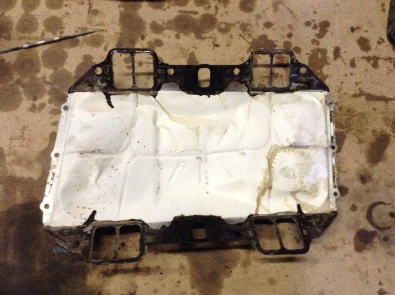

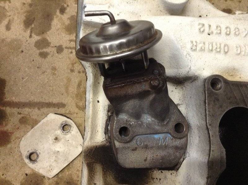

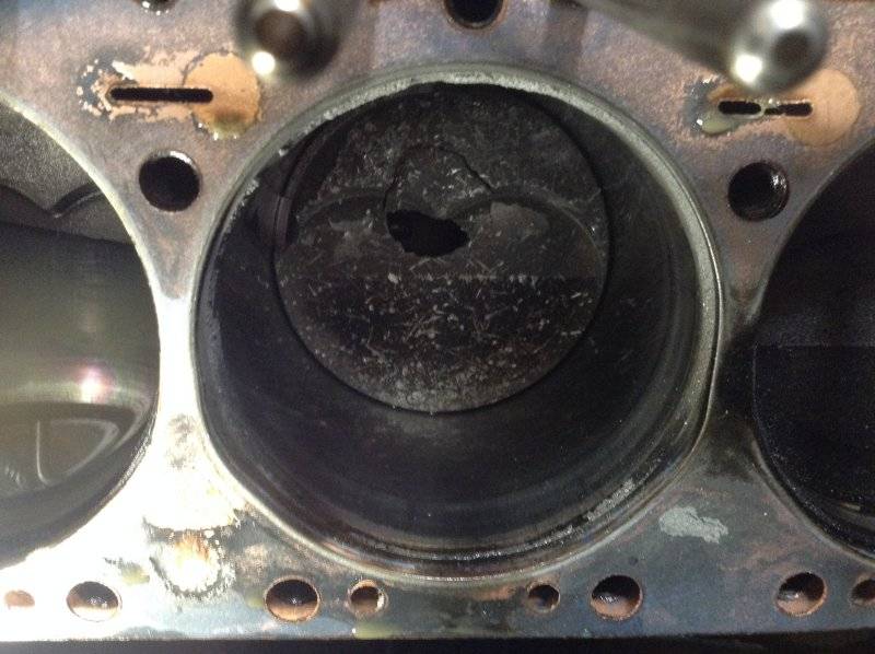

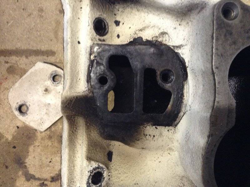

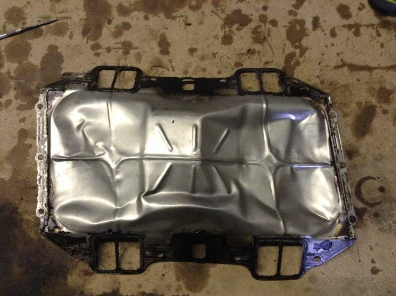

I plugged the EGR on a 1976 440-3 and blew up the engine. 1st pix is of the blanking plate removed with black gas having blown past gasket and second is the EGR being put back on. Dented Valley Pan pixs shows what the over pressure did. And finally, the hole in the new KB piston. This was my first ever attempt at a rebuild. I had great vacuum pressure until I didn't. Now I am re-doing the build.

Egr block off has nothing to do with your troubles. But it does look like something was banging around and punched a hole in your piston.

I honestly do not know what happened. PCV rattled in its casing so its not that. I know I sealed this engine tight. I used Permatex form a gasket everywhere. With 1000 miles of break in the vacuum gage showed strong vacuum (15-20). The blanking plate for the EGR has black exhaust gas where the pressure had blown through the seal. Head gasket blew between 4 and 6 pistons. Some of the time, after turning off engine I could hear a slight hissing sound.
I'm with you guys in that the EGR seems unlikely but thats what I'm hearing from others...there seems to be a lot of uncertainty with EGR. Thanks, Bob, for EGR explanation. It makes sense and now I wonder about the intake manifold....and everything else!
We (seasoned mechanic, machine shop owner and myself) would like to know what happened. I stated EGR was at fault because of online discussions from searching "hole in piston". There was a small sounding explosion (less than a backfire) that I heard and dismissed. Maybe very hot internal temp and unburnt fuel created that little explosion. The Edelbrock carb plunger was adjusted for max gas dump for better get up and go which may have added to this problem. Even with the hole in piston 6 and number 4 being slightly melted I still made it home, over 100 miles and through the mountains.

Follow up on the hole in the piston and piston melting. After some reading, I think the damage was from pre-ignition.
