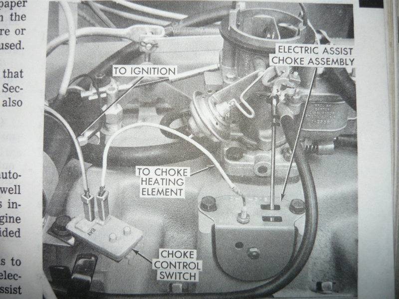

Is that choke controller attached to the coil bracket in the foto?
Is not attached to the coil bracket, but sharing same mounting bolt at manifold for the coil bracket. That is for small block. Big blocks mounts on a head bolt provision and the controller got a ballast resistor attached to set dual voltage stages depending on engine bay temperature. Will grab a pic and post
this is big block ( pic from odzking's 73 SE restoration album )
( uses same head provision circled on driver side, but being turned around, provision changes to rear )
blue RUN wire on engine harness runs like this on BBs since 73, so an untouched harness should have this provision there.

and this is the correct choke control for BB... with the ballast attached to set dual voltage stages depending on engine temperature:
well, no, wait... I think it mounts on last intake manifold bolt on that side!!! LOL... damn! I can't remember! 6 and a half years with my car in pieces 1000 miles from home! sorry!
Well, in the black and white factory style foto already posted, the intake manifold bolts look a step lower than the bolt holding the choke controller. That's why I was asking if that was in common with the small block coil bracket.
I am interested because of the recent purchase of NOS electric choke controller and electric choke (going to change factory SB intake manifold from '72 to '73 style.
